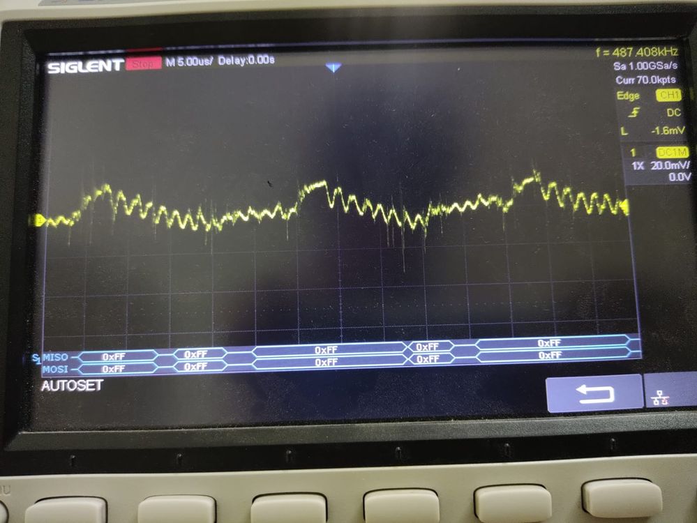

I connected one probe to the SPI MOSI pin and sent the data 0xE to the TFT, but it showed 0xFF.

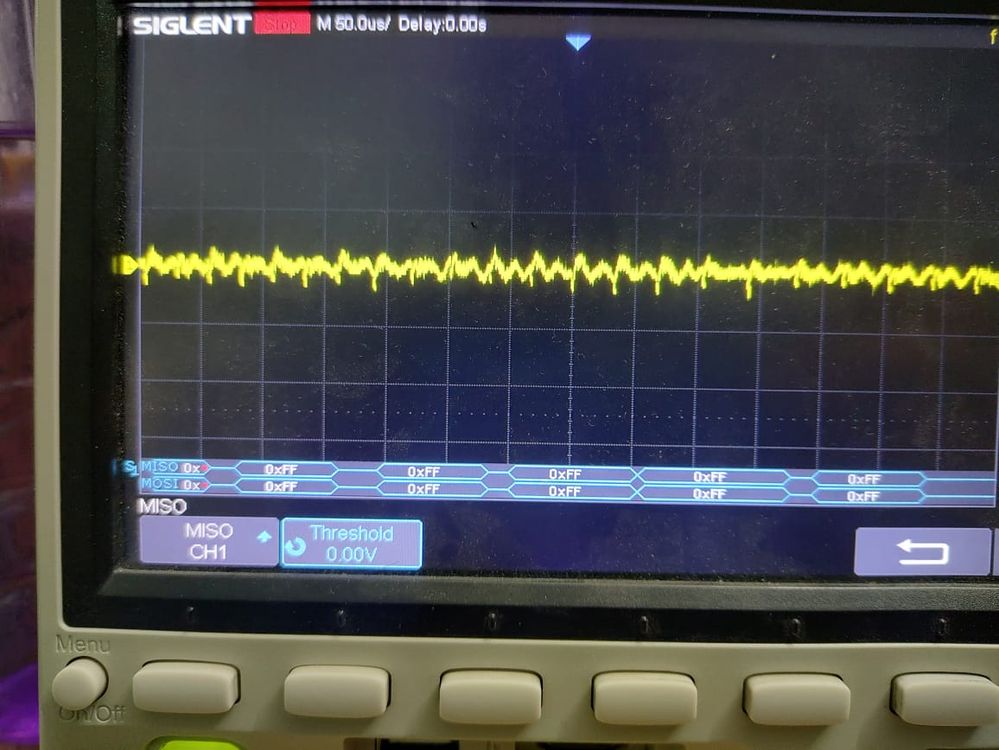

hi @AScha.3 sorry for my late reply. I tried, but the signal shows a value of 0xFF
2024-07-21 10:52 PM
I see no useful signal...
Ask (your teacher ? ) how to use a scope.

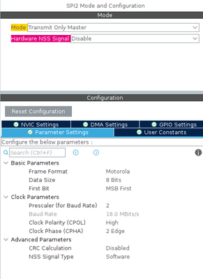

@AScha.3 Our company is small, and I am a fresher, so no one is available to help me. Please give me some guidelines. How do I calculate the prescaler value for SPI in the ILI9488? The HCLK is 250 MHz. Based on the dot clock frequency (DOTCLK = 20 MHz), I set the prescaler
2024-07-22 1:04 AM
Ok,
so see in Cube/IDE what you set:

@AScha.3 I checked that the SPI is working well on the oscilloscope and i saw the signal also, but the TFT is still not working. i want small changes in my TFT like showing bg color.if i get anything,easily i will take into another level.
