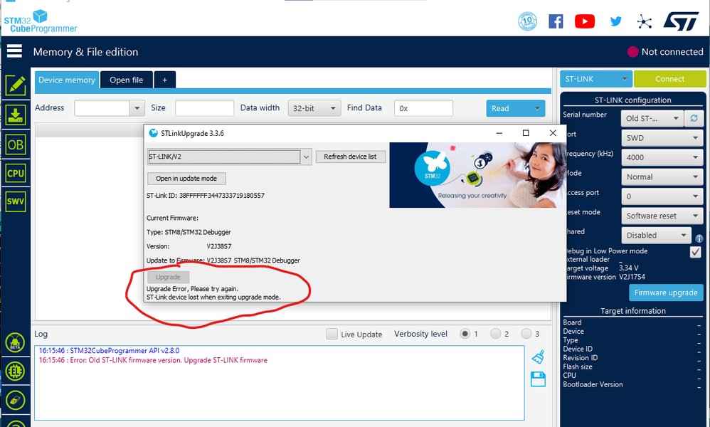

firstly I got an error on the Arduino IDE:
Error: Old ST-LINK firmware version. Upgrade ST-LINK firmware
Error: Old ST-LINK firmware! Please upgrade it.
then I followed the instructions on how to upgrade, this is what comes up in the STM32CubeProgrammer:
can someone please help?
2021-08-23 1:20 AM
2021-08-23 10:47 AM

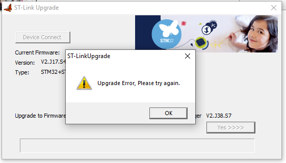

2021-08-23 7:47 PM
thanks for your response
i tried the standalone upgrade tool as well, here is what i get;
