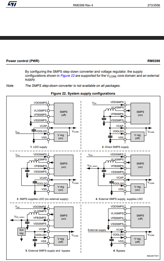

Hello, in my plan, I want to use a standart power supply (LDO) for STM32H757xI in package WLCSP156.
In the manual for STM32H757xI I didn't find any information on how it should be connected
Is it correct ?
VLXSMPS (GND)
VFBSMPS (GND)
VSSDSI (GND)
VSSSMPS (GND)
VDDSMPS (GND)

See also AN4938, Getting started with STM32H74xI/G and STM32H75xI/G MCU hardware development:
via: https://www.st.com/en/microcontrollers-microprocessors/stm32h757xi.html#documentation
