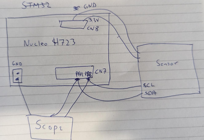

2024-09-09 2:28 PM
I have attached a diagram. Im using pins PB8 and PB9 on CN7 for i2c and using the 3.3V and GND from CN8 to power the sensor. I have attached the scope to pb8 and pb9, using the GND near the end of the board.
2024-09-09 2:30 PM
The sensor has 4.7K pullup resistors of it's own. So i try to use those instead of the stm32, by turning off the pullups.
2024-09-09 10:37 PM
Keep the wires short, use the GND pin(s) for the sensor board and the scope on CN7.
It shouldn't matter too much if you keep the STM's rather weak pull-ups on, but check if it makes a difference.
Anyway, saying that voltage drops back to 3.3V, maybe you're just measuring some overshoot (due to non-terminated flying wires and the scope GND line)?
