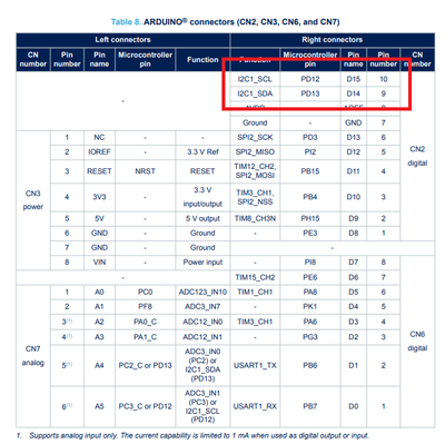

From the user manual of the board UM2488:
I2C1 is available on the Arduino connector CN2/ pins 9 and 10:

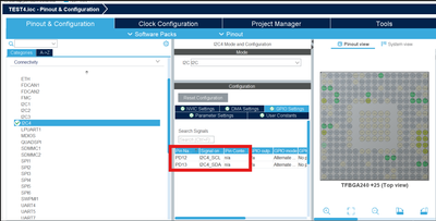

While working on the configuration using STM32CubeMX, I noticed that PD12 and PD13 are assigned to the I2C4 peripheral. However, according to the user manual and the ARDUINO connectors table (CN2), these pins are listed as I2C1_SCL and I2C1_SDA.
Could you please confirm if this configuration is correct? Is it normal that CubeMX assigns I2C4 to PD12/PD13 while the documentation refers to I2C1 for the same pins?

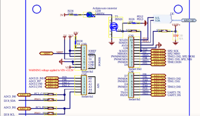

Additionally, could you kindly provide me with the official schematic of the STM32H750B-DK board or share the official link where I can download it? This would help me verify the exact I2C signal routing to the Arduino connectors.

I found this link containing the schematic
https://fr.scribd.com/document/762570249/en-mb1381-h750xb-b01-schematic

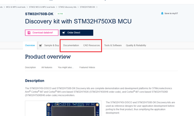

The documentation (user manual and the schematics) of the board is available on this link:
The schematics are available on "CAD Ressources" tab
Refer also to this article on How to find STM32 board schematics.

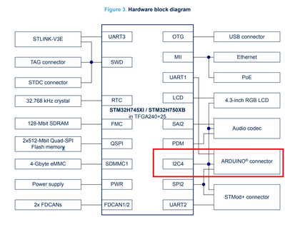

Now regarding your question about I2C1 or I2C4, and according to the the product datasheet, PD12 and PD13 has I2C4 function. No I2C1 on these pins. So I think it's a typo in the UM2488:
Also in the same user manual / figure 3 it sates that I2C4 is available on the Arduino connector:
I will escalate that for fix. (Internal ticket 206170)

2025-04-21 3:47 AM - edited 2025-04-21 3:51 AM
In CubeMx you need to use I2C4:

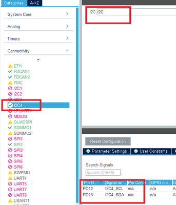

Can I use only I2C4 in CubeMX? I cannot use the other I2Cs even if I clear the pinout?
2025-04-21 5:41 AM
You cannot use other I2C instances in this board. Look at the CubeMx (the screen shot I've shared) they are marked in red because their IOs are reserved and used by other stuff on the board.
