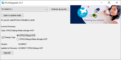

As per the attachment shown, When I connect the Nucleo stm32f411 board, I dont want NOD_F411RE (D:) Drive to come , I just want to see its debugging and upload code interface only with Keil IDE. So need support on how to remove it.

Do a ST-Link firmware upgrade in STM32CubeProgrammer and change the type to not include the mass storage.
