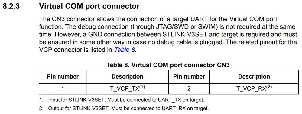

The ST-LINK/V3 does, and has a diagram in the manual

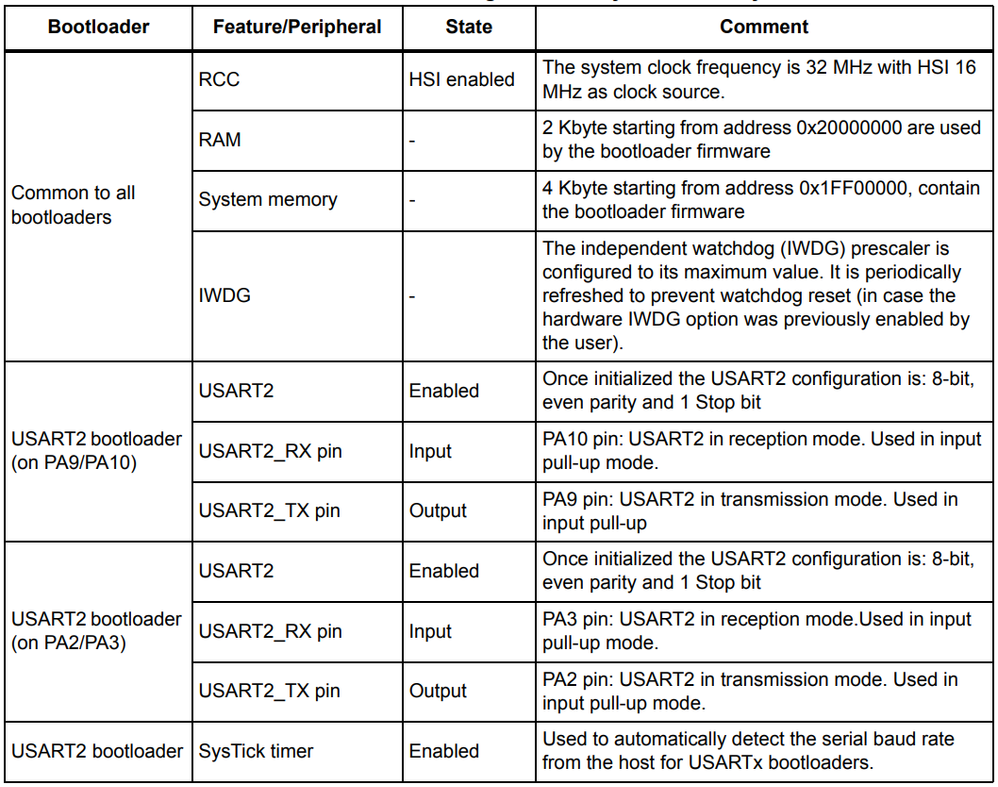

For UART programming, check App Note AN2606
Typically want to export RX, TX, NRST, BOOT(0), GND

Hi Tesla,
I looked at the various st-link V3 data sheets, and I still don't see a table that explicitly states "usart Tx ties to this pin".
It may be a terminology problem. These devices only program via the USART.
Which manual were you referring to that has a wiring diagram?

As mentioned by Tesla, you can find in AN2606 STM32 microcontroller system memory boot mode - Application note the hardware resources used by this bootloader.
In section, 54 STM32L01xxx/02xxx devices bootloader, you can find the USART's programming setup.
