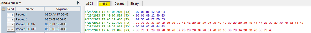

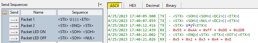

Blue data is just binary data
Red data is the string

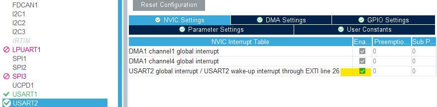

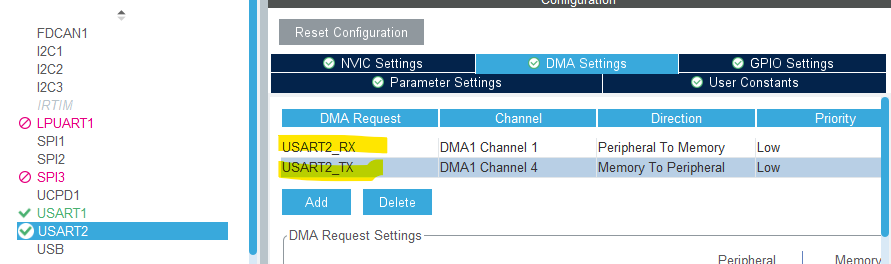

Be sure to enable DMA Tx/RX for both UART ports as well as enable the NVIC interrupt for the UART.
