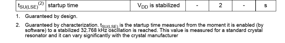

2023-04-13 7:48 AM - edited 2023-11-20 7:18 AM
LSE startup can be long... (from F407 data.)
