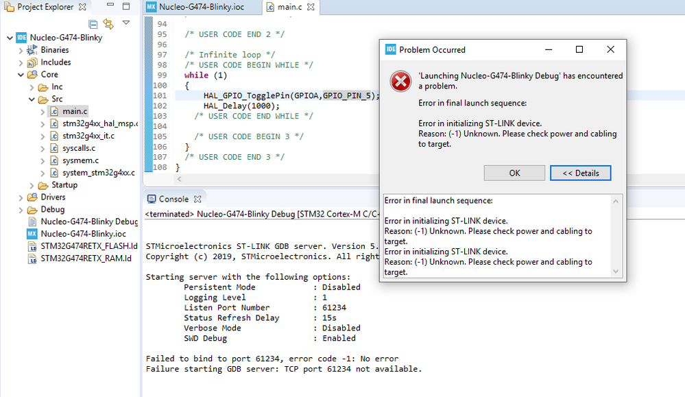

trying to blink the LD2 on PA5. Getting following error. Please help in resolving.

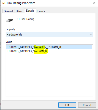

STLINK is installed and showing in Device manager

Looks like the ST-LINK drivers are not installed.
My Details tab reads "STMicroelectronics STLink dongle", but yours shows only generic USB ID.
The drivers can be downloaded seperately (STSW-LINK009).
