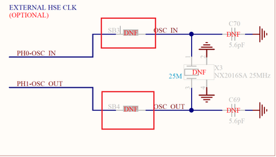

I use NUCLEO-H753ZI with processor STM32H753ZI. In deafault settings there is not mounted external oscillator, but I need application where it's mounted. So I added oscillator 25Mhz (same type as is described in schematic for board) and capacitors. Then I try to run FatFs_USBDISK_Standlone (intended for STM32H743 - STM32H743I-EVAL). If I switch on internal oscillator (HSI) example is running. But if I use external oscillator (default settings of project) the frequency is not correct. I verified it by test led blink with timer (the measured frequency is about 3 times smaller then calculated). Also if I try to measure oscillator frequncy (on C70 - see schematic for board) i can see signal with 8Mhz frequency on oscilloscope (the waveform is similar to a charging and discharging of capacitor ~ triangle waveform).
Does anyone know what may be incorrect in my settings?

I just found the problem. There is also bridge SB45 that must be desoldered, otherwise its driven from ST link.
2024-03-19 12:40 AM - edited 2024-03-19 12:45 AM
Did you solder the solder bridges SB3 and SB4? (not soldered by default):
Also use MCO function to output the HSE frequency on one of the dedicated pins instead of probing the crystal signal on its pad.
2024-03-19 1:23 AM - edited 2024-03-19 1:26 AM
Thank you for your advice.
Yes, I did. Bridges are soldered.
I enabled MCO1 output and set 23th bit of RCC->CFGR register (on the output is hse_ck signal), MCO1 precaler is switched off. The signal on dedicated pin (PA8) has also 8MHz frequency.
