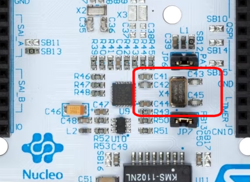

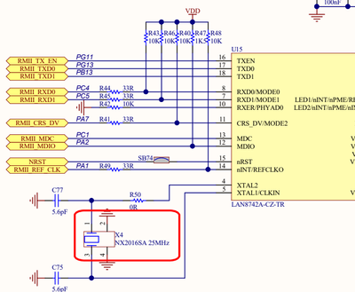

@HMsDobby2 wrote:Where is the X4 used?
You can see that in the schematics:
Also from the picture of the board:

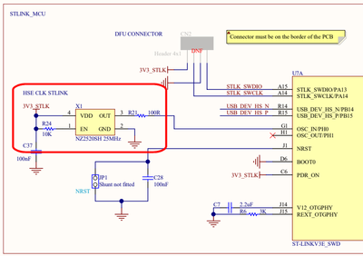

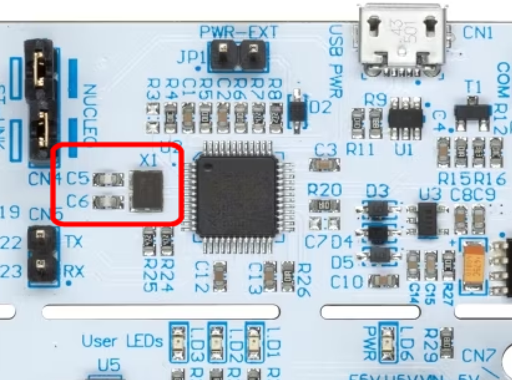

@HMsDobby2 wrote:Plus, Is it correct that the MCO (default) from STLINK-V3E uses the X1 source?
Again, see the board schematics:
(so, actually, it's not just a crystal - it's an oscillator).
Also, from that board picture, X1 is adjacent to the ST-Link chip - so it will be the crystal (rather, the clock source) for that chip:
