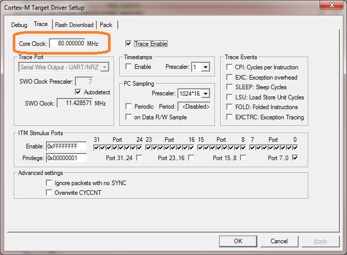

It means your speed setting doesn't match that of the core, or the SWD settings in general are not coherent.
2019-09-19 9:28 AM
I imagine that you are right. But, I can find no information on the settings. How do I know what the speed setting should be ?
2019-09-19 9:42 AM
Know what speed you're clocking your device, and tell the debugger what that is. Here an L4 part I'm clocking at 80 MHz (SYSCLK)
Other settings will depend on the model of ST-LINK, here a V3, so higher SWD bus settings, the defaults should work for those. The "Trace - no synchronization" means either the target speed is wrong, or the clock gearing is otherwise incorrect/incompatible. ie internally incoherent.
