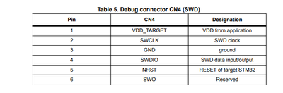

It is a pretty standard thing that a debug probes needs to see the target voltage - that's why the pin is there on CN4!
Surely, you can find a point somewhere on your board to provide the 3.3V to the ST-Link?

see cn4 :
pin 1 has to get 3v3 .
