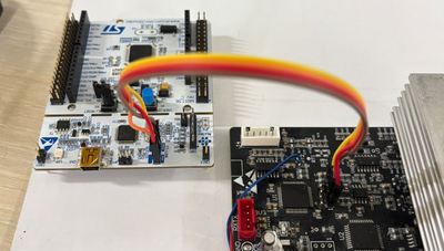

ok, so the target board is the big board in pic ?
But your circuit shows just F103 , even without crystal ?
Try connect with CubeProgrammer , set: software reset , normal; and show , what its "telling".

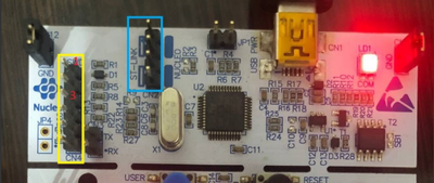

You seem to be using the wrong connector on the Nucleo board:
Rather than those jumpers (blue in the picture below), you should be connecting to CN4 (yellow):
Please see this recent thread:
Use nucleo-64 ST-Link debugger for another MCU.
PS:
This is described in the User Manual for the NUCLEO-F103RB board:
via: https://www.st.com/en/evaluation-tools/nucleo-f103rb.html#documentation
