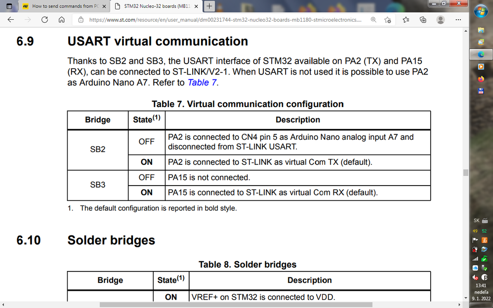

As describe Nucleo pdf you need config ...
2022-01-09 5:10 AM
Thank you, this solved the problem.
I used PA2 and PA3 instead of PA15 and that's why I can send but can't receive.
