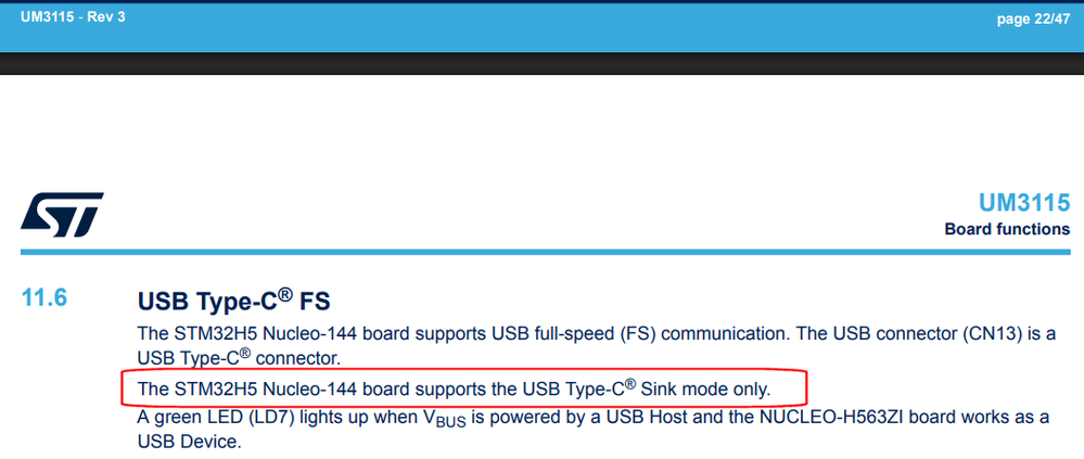

Just in case you're using a Nucleo 144 with STM32H563ZIT6, host mode is not supported on that board.

Why is host mode not supported on the STM32H563ZIT6 nucleo if it is supported by the chip?

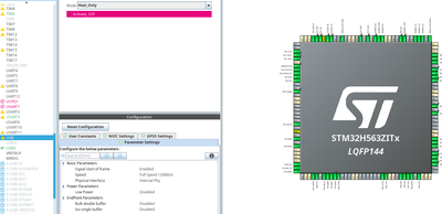

I've been trying to implement USB Host on a custom board with the STM32H563RGT6 with several example projects from ST with the ST USB_Host and FATFS middleware provided. In every case I just constant USB interrupts that blocks all other operation.

It is really unfortunate that the Nucleo Board STM32H563ZI does NOT support the user USB plug CN13 to act as USB Host.
So there is no way using this board to test how an STM32H5xx embedded device would work with USB sticks for example.
2026-02-16 2:54 AM
@PFlor.2 wrote:Why is host mode not supported on the STM32H563ZIT6 nucleo if it is supported by the chip?
via: https://www.st.com/en/evaluation-tools/nucleo-h563zi.html#documentation
I guess that limits it to Device only?

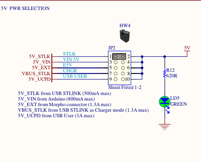

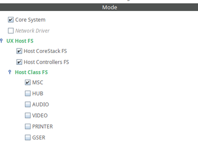

2026-02-16 3:17 AM - edited 2026-02-16 3:57 AM
afair
I used the user-usb as host...just you cannot expect its working as full USB-C !
To connect an usb-stick it will work, just use an adapter usb-C -> usb-A (as i did ).
And to get the needed 5V ...just put some jumpers on the block:
i have 3 jumpers on : 1-2 , 7-8 , 9-10 ; so you get vbus to the user usb , from st-link/debug usb.
Was this, with Azure usbx:
