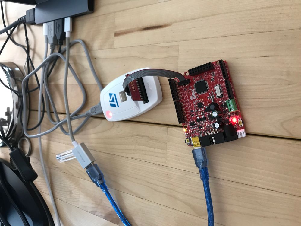

2020-04-04 3:05 AM
Hi Ons,
I don't know if desribing it would do any good so here is a picture showing my cable connection:
As you can see I am using one cable to connect the board to the PC with the micro USB port and one cable to use the StLinkv2 with the JTAG cable.
I was hoping that after loading the code on the board I would be able to loose the StLinkv2 and communicate via RealTerm with only cable remaining.
Again, thank you for your feedback.
Sincerly,
Jan
2020-04-10 4:00 AM
Hi JWojt.1,
It seems that your setup is good.
