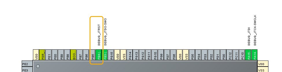

And from ST documentation on the STM32G4:
https://www.st.com/resource/en/product_training/STM32G4-System-Debug_DBG.pdf
Page 6
2023-03-17 12:39 PM
NRST is cpu reset.
JTRST is jtag /debug connection reset.
your thought wrong.
why dont use SWD or trace asyn.Sw ? need old standard jtag ? then jtrst -> jtrst debug probe.
2023-03-17 12:48 PM
I would connect NRST to a debug header, but it's not the same as JTRST
