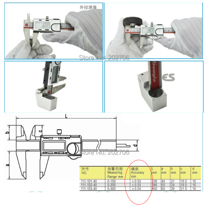

The manufacturer of this tool and the measurement tolerances are shown below (AliExpress).
This instrument is not enough accurate and does not have the required precision to measure such dimensions ranges.
It’s then not appropriate to notice a dimensions deviation of 10µm with a measurement tool which accuracy is about +/-30µm or +/-40µm.

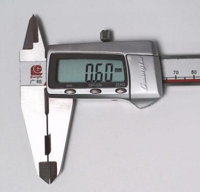

We used electronic digital caliper,We took 30 samples from one package,But most of them measurement results are 0.610mm,Small measurement results are 0.600mm,We want to know is within an acceptable range?
The electronic digital caliper like this
