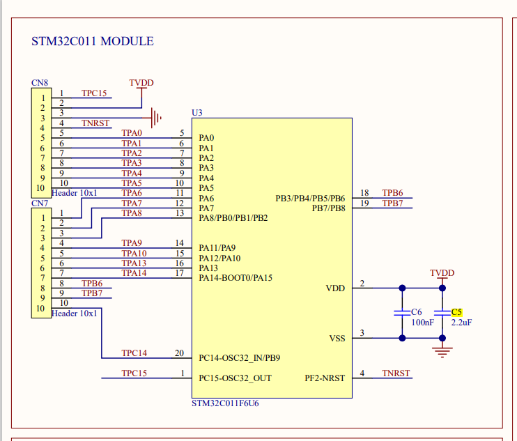

Schematics : https://www.st.com/resource/en/schematic_pack/mb1684-c011f6-b01-schematic.pdf
Decoupling capacitors on the single power supply on the DIP20 adapter it seems.

Many thanks. I will have a look to the schmatics.
2023-01-29 10:02 AM
Schematics and Bill of Materials should be under the "CAD Resources" tab of the assorted DISCO/DK, NUCLEO and EVAL boards
