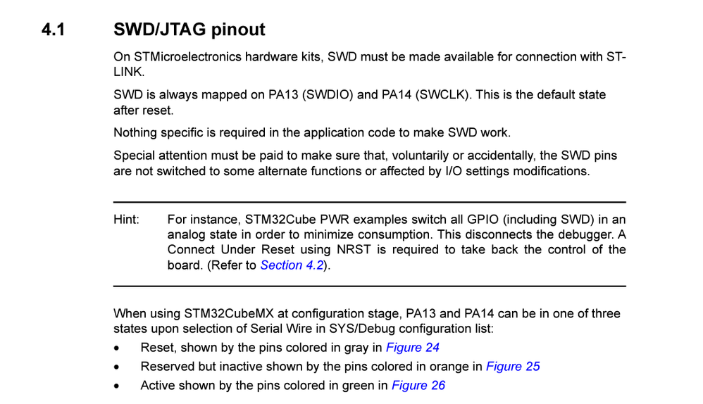

Please refer to the AN4989 section 4.1 to know all the details

Hello Sarra,
Thank you for the reply. So to confirm, based on this document:

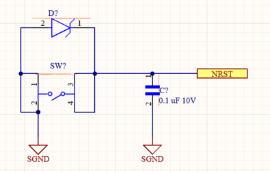

NRST (NRST) - I have a physical push button for my custom board that resets it (similar to how the evaluation boards do it). For a proof of concept board, is this sufficient and I won't need the NRST pin to program?

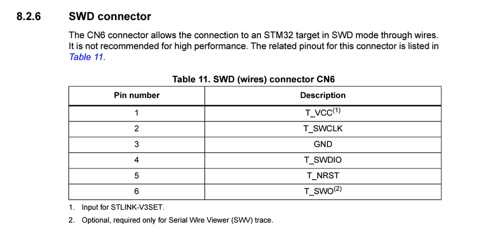

Have a look at the pin-out of the ST-LINK connector for the used signals.
I always route the NRST to the programming/debugging connector because the CubeProgrammer or the CubeIDE may use it.
Or look at the schematics of a board like the NUCLEO_H743 and route the signals on CN5 and CN6 to your programming/debugging connector.
CN5 is for the Virtual COM port (VCP) supported by ST-LINK, very handy for debugging ( AN4989 section 7).

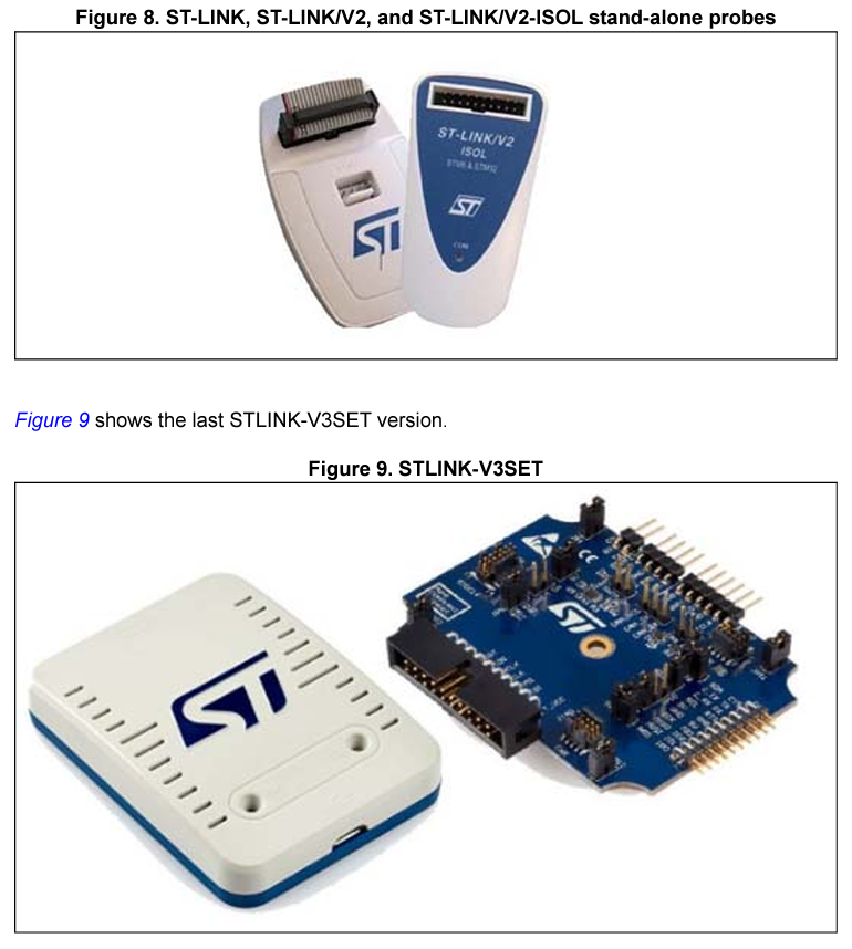

You also need local VCC (most of the time 3.3V) if you use a ST-LINKV3SET

I fully agree that the AN4989 is helpful, but there are details missing that are important for some of my decisions.

For the ST_LINKV3SET the natural connector to use is the CN1 (STDC14). Look at the manual chapter 9:
STDC14 connector (1.27 mm pitch) on target application: pinout detailed in Table 6. Reference Samtec FFSD-07-D-05.90-01-N-R
(The CN6 is obviously a 0.1" header).
The NRST pin is not pulled down. It is pulled up by an MCU internal pull up, and set to ground to activate the reset. You can keep the button for manual reset and also connect the reset pin to the debug connector.

I am looking to optimize space on this board, so having to have a header connector on my board with that many pins will be problematic (This board is fitting in a tight space). That is why I was leaning towards CN6 and then just strictly use SWD.
When you say obviously CN6 is a 0.1" header, where are you basing your information off of? If that is the case, then that's preferred because I can more easily integrate the 0.1" pitch wire harnesses in our lab.
