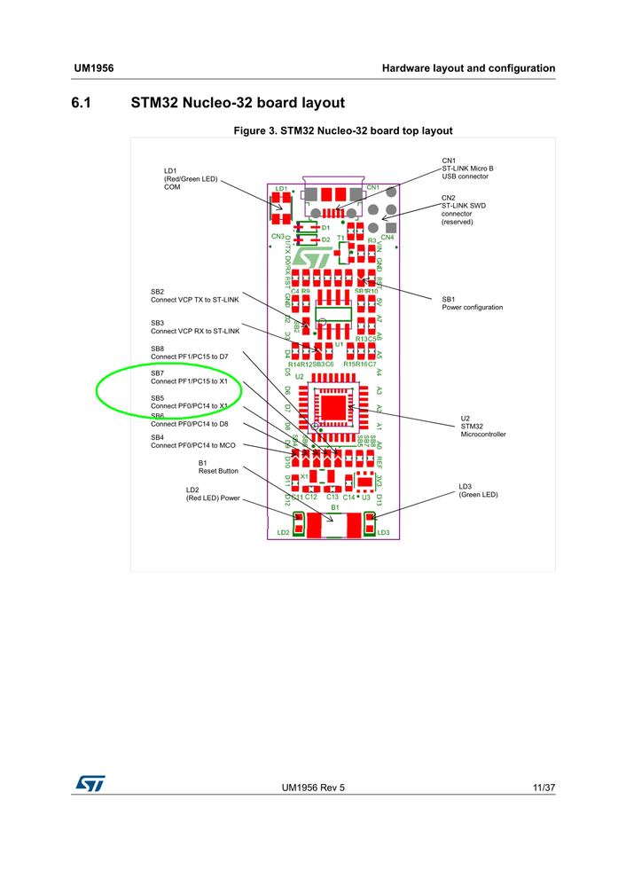

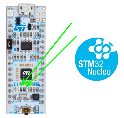

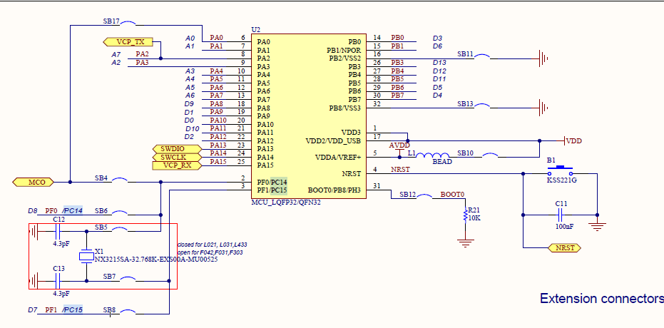

this is the photo of the relevant part from the schematic

You may need to remove also the code which enables the LSE (i.e. click in CubeMX to disable LSE), as it overrides any GPIO settings for those two pins.

thank you very much, i chang the resistor and it is working now.
im using LSE in a different part. do u think i still have to disable it?
