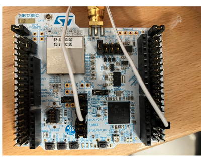

what kind of hardware do you use to link the board with your pc?
can you please sent a picture of the board in use especially the state of the jumpers?
for me I use a normal USB cable (type A to micro USB type B)
