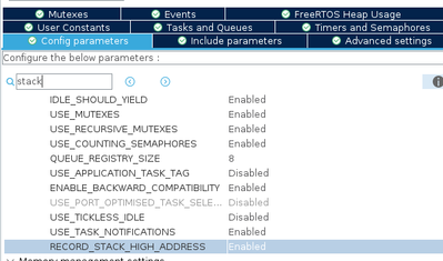

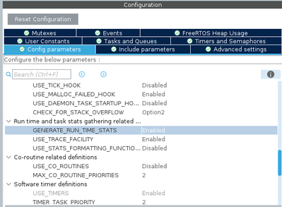

Then additionally you can go into freeRTOS settings and enable a few things.
1. Generate Runtime Stats.
2. Check for stack overflow. (This hook has saved me so much headaches over the years)
3. Also enable stack high address.
Don't ask me about the runtime %. No idea :) Never used it.
EDIT: You need to set a break point somewhere in your code to see the stats being updated.

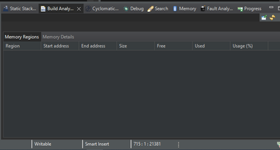

I have a new problem.
the "Build Analysis" windows of the STM32CubeIde show nothing. how do I get information about my build?
