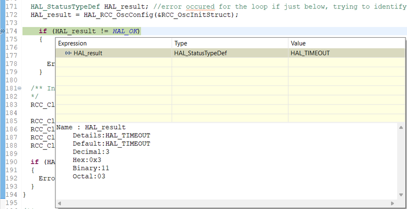

I am configuring an STM32F401RE and its RTC on the STM32CubeIDE software
I've written an program that debug without errors. But ErrorHandler() is called during the RCC Oscillators initialization (during the "SystemClock_Config(void)" process).
I think i'have followed the steps and the right parameters, but would you have a clue of where could it be from ? Let me know if you need additional pictores of the system configuration of the .ioc file maybe
RCC_OscInitStruct.OscillatorType = RCC_OSCILLATORTYPE_HSI|RCC_OSCILLATORTYPE_LSE;
RCC_OscInitStruct.LSEState = RCC_LSE_ON;
RCC_OscInitStruct.HSIState = RCC_HSI_ON;
RCC_OscInitStruct.PLL.PLLSource = RCC_PLLSOURCE_HSI;
RCC_OscInitStruct.PLL.PLLM = 16;
RCC_OscInitStruct.PLL.PLLN = 336;
RCC_OscInitStruct.PLL.PLLP = RCC_PLLP_DIV4;
RCC_OscInitStruct.PLL.PLLQ = 7;
Error_Handler(); //the call of ErrorHandler() happens here
