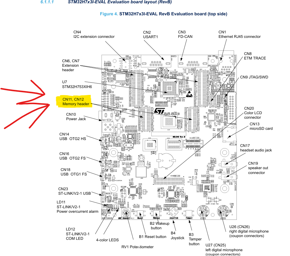

I am currently working with the STM32H743Eval2 evaluation board, and I'm facing a challenge with the smaller pins on the board. Specifically, I've noticed that the standard-sized pins do not fit in these smaller pin slots. how can I reach these pins.

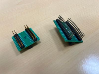

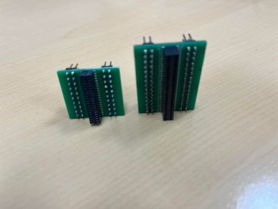

Internally we have a such adapters to access that connectors on H7/F7 Eval boards:
But unfortunately they are not available on the market :frowning_face:.
I would suggest:

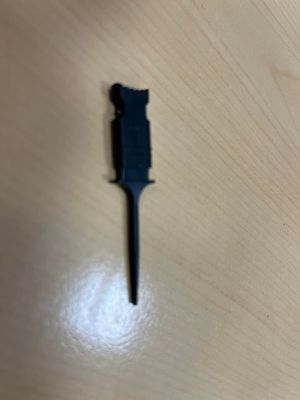

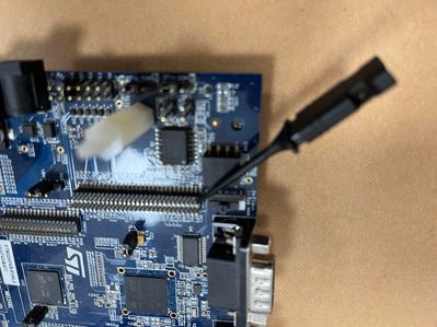

1- The usage of that kind of "clips" (I don't know if this is the right naming) that you can attach directly to the pin:

Perhaps pull the BoM from the "CAD Resources" tab on the product page. Determine the header type and pitch from the BoM
2024-05-14 5:24 PM
https://www.st.com/en/evaluation-tools/stm32h743i-eval.html
https://www.st.com/en/evaluation-tools/stm32h743i-eval.html#cad-resources
https://www.st.com/resource/en/bill_of_materials/mb1246_bom.zip
CN11 / CN12 Header,2*20,1.27*2.54mm,with positioning pin,SMT,333240M121
I would suggest:
