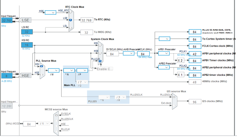

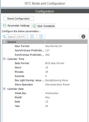

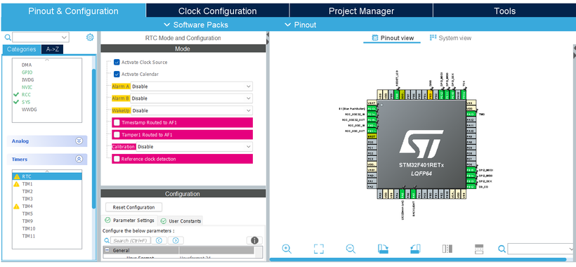

I am configuring an STM32F401RE and its RTC on the STM32CubeIDE software
I've written an program that debug without errors. But ErrorHandler() is called during the RCC Oscillators initialization (during the "SystemClock_Config(void)" process).
I think i'have followed the steps and the right parameters, but would you have a clue of where could it be from ? Let me know if you need additional pictores of the system configuration of the .ioc file maybe
RCC_OscInitStruct.OscillatorType = RCC_OSCILLATORTYPE_HSI|RCC_OSCILLATORTYPE_LSE;
RCC_OscInitStruct.LSEState = RCC_LSE_ON;
RCC_OscInitStruct.HSIState = RCC_HSI_ON;
RCC_OscInitStruct.PLL.PLLSource = RCC_PLLSOURCE_HSI;
RCC_OscInitStruct.PLL.PLLM = 16;
RCC_OscInitStruct.PLL.PLLN = 336;
RCC_OscInitStruct.PLL.PLLP = RCC_PLLP_DIV4;
RCC_OscInitStruct.PLL.PLLQ = 7;
Error_Handler(); //the call of ErrorHandler() happens here

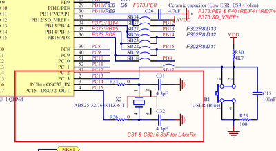

Hello @willow ,
Thank you for sharing the file.
I didn't reproduce the behavior with NUCLEO-F401 board. Could you confirm you're using that board?
Also did you modify something on it? especially LSE part of the board?

Hello @willow and welcome to the community,
Could you please share your ioc file?
2024-05-15 2:14 AM
Of course @mƎALLEm and thank you for your answer, here is my .ioc file attached

2024-05-15 2:38 AM
@mƎALLEm wrote:did you modify something on it? especially LSE part of the board?
@willow is it a brand new board, straight from the factory, or has it had previous users and/or uses ?
2024-05-15 2:46 AM
Check especially that part of the board:
2024-05-15 5:26 AM
Yes in deed, im using the NUCLEO F401RE ! No i didnt modify the hardware
2024-05-15 5:27 AM
it has previous user and uses but always for my project purpose
2024-05-15 5:28 AM
im gonna try do that and ill update you what it shows, thank you very much
