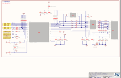

Hello @Promise_Conti and welcome to the community,
By defaults, Nucleo-H7A3ZI-Q does not have the PHY nor the transformer for the ethernet function.
See the schematics. All the components related to the ETH are not fitted:

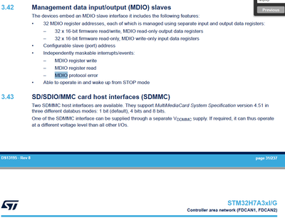

As LCE wrote, the STM32H7A3 series don't have Ethernet . In particular, no ethernet MAC component.
There is a STM32 peripheral called "MDIOS" ("Management data input/output") that could be used for very basic serial interface, but the Ethernet MAC component is missing in this specific STM32H7 to do real Ethernet communication with an external PHY.

The STM32H7A3 seems to have the MDIO interface, my problem is that it seems responsive even when called via HAL_MDIO

2024-10-07 10:57 PM
Interesting, I never saw the MDIO interface on ICs without ethernet before.
If there's no ETH peripheral, you cannot init it.
But then you probably have to init the MDIO peripheral (it looks like it is an extra peripheral), starting with the clock etcpp.
And init the GPIOs with the MDIO alternate functions (check datasheet), which you probably do in "static void MX_MDIOS_Init(void);" ?
