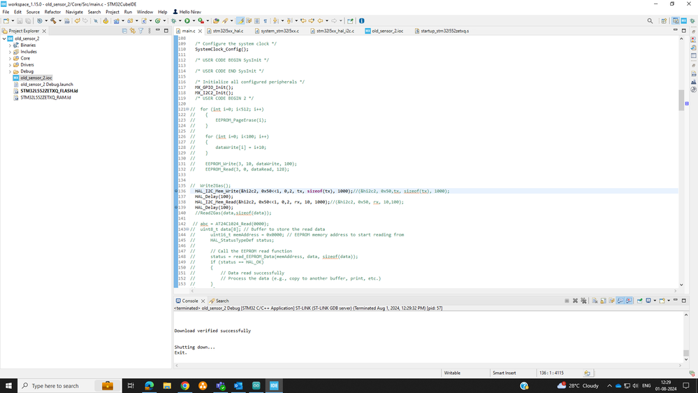

HAL_GetTick() returns the value -128 when called in I2C write memory bite
Here are the code snipets how to resolve this error

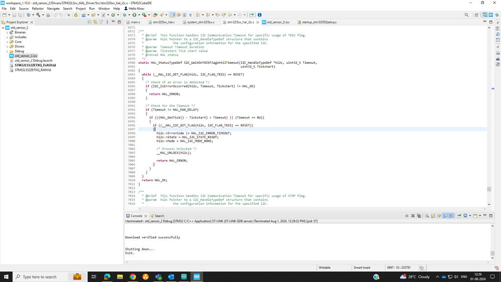

Why do you think this?
The return value is uint32_t. It cannot be negative.
Use HAL_I2C_IsDeviceReady and ensure it returns HAL_OK before using any other I2C function.
If it's not returning HAL_OK, there is likely a hardware error. Perhaps SDA/SCL is miswired, or you have missing external pullup resistors, or other issue.

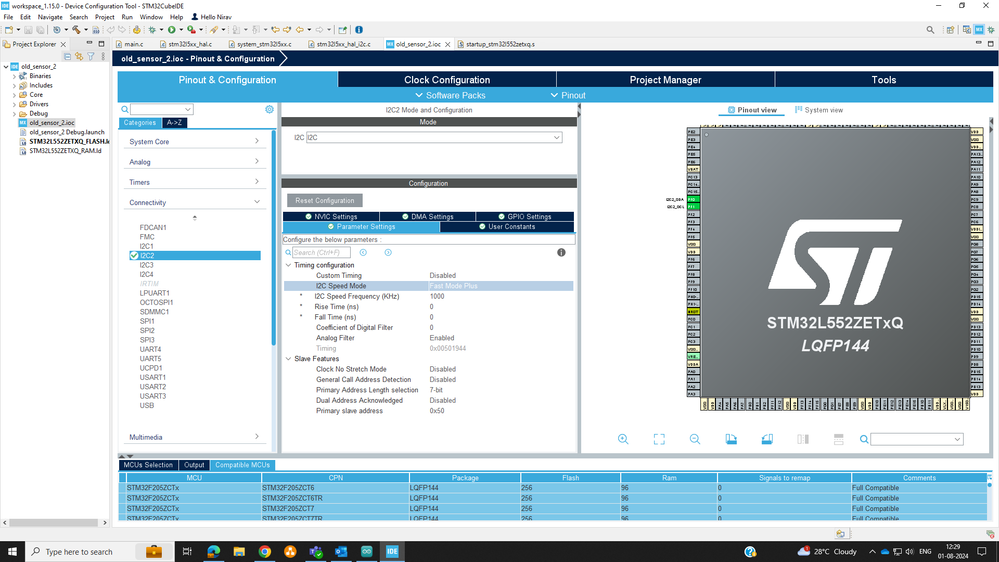

2024-10-10 12:46 AM
it's not returning HAL_OK,.SDA/SCL is wired properly and external pullup resistors are also present. Do let me know what other issue can be there and how can i solve it
