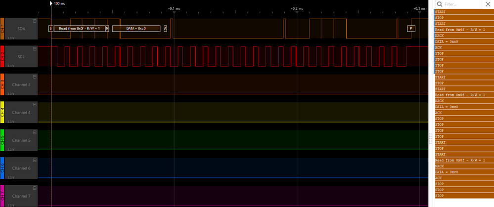

I am also attaching images to illustrate the frames and errors encountered.

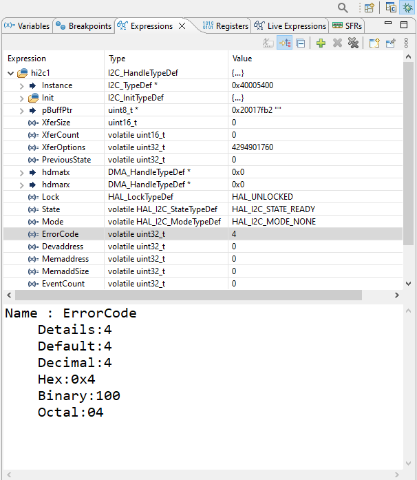

Error during debugging, HAL return

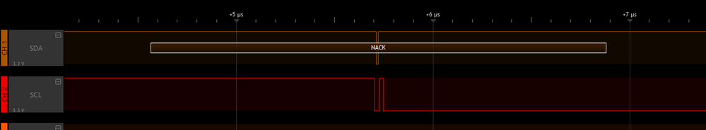

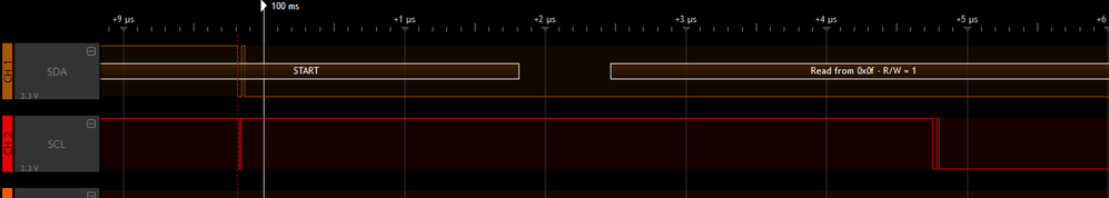

General frame
Frame focused on the clock
More detailed clock frame

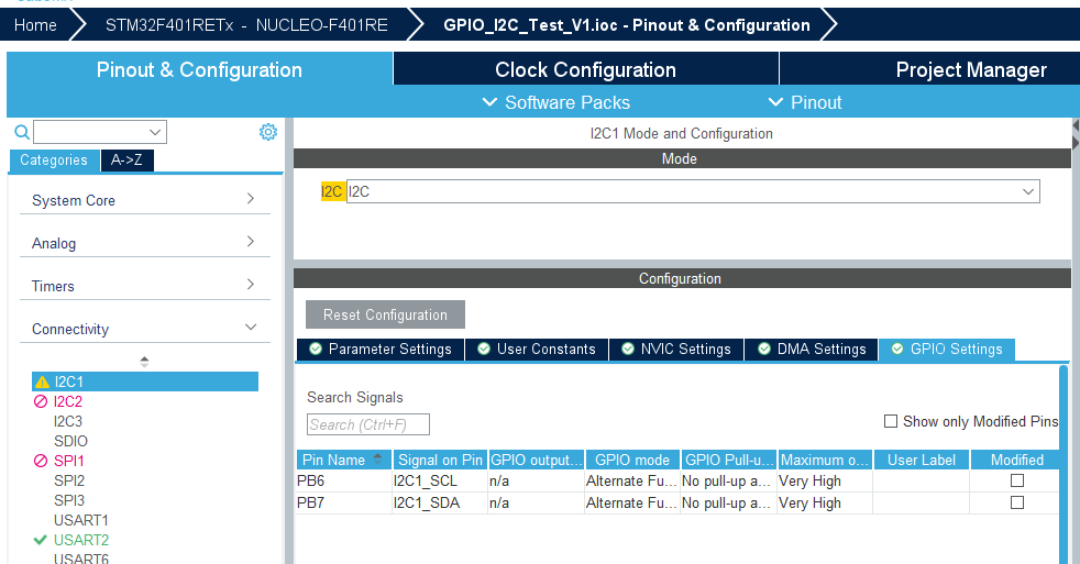

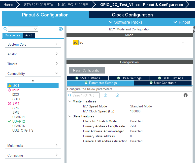

I²C configuration
I²C configuration

HAL_I2C_ERROR_AF (4)
ACK failure from the device

The decode of the general frame in the logic analyzer isn't at all helpful.
Should have the 0xE0 slave address, 0x00, 0x38
RW1063_send_command(0x38); // 8-bit mode, 2 lines, 5x8 characters
2024-06-23 1:43 PM
I’m trying to understand. 0xE0 is supposed to contain 0x00 + 0x38 -> but then, is it the HAL that combines the two pieces of information? Is it one address per pointer?

Well the issue is going to be easier to solve if your logic analyzer output (protocol parsing) actually reflected what the signals indicated.
And then you associated the faulting GPIO on the same time line.
