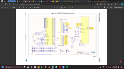

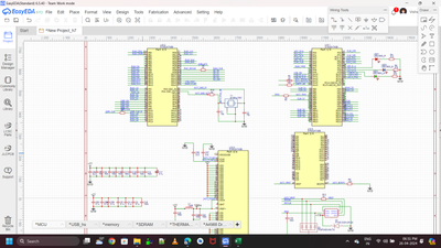

Thank you for your kind reply. Yes, my role is solely to select the chip and design the schematics, while a senior colleague handles the PCB design. However, he is not familiar with the STM32. Another colleague and I are involved in developing our company's own product using STM32. We have successfully demonstrated this using the F769-DISCO board, and now I need to use an 8.88" display with at least a 1080x800 resolution, so I decided on the H7. Unfortunately, I initially learned schematics from a dedicated H743 100-pin video. As I require SDRAM, LTDC, and eMMC, this would occupy many pins, so I switched to the STM32H743 in a 208 LQFP package instead of the previous one.
As you mentioned, I found a reference schematic for the H753 in the hardware application note. If I follow this reference schematic exactly, will my MCU function properly? Regarding the selection of active components, which should I prioritize? The STM32H753 eval board contains complicated and obsolete parts. What steps should I take after following the basic schematics provided in the reference?
this is partially followed by ref..

STM32H753 is exactly same as STM32H743, and has crypto features that may be useful for you.
The only thing to worry about: make sure it is "stepping V", not "stepping Y". The latter is obsolete.

Thank you for your reply. As I have successfully used the STM32F769-DISC0 for displaying waveforms and interfacing with a thermal printer via the SPI interface, I now need to develop custom hardware capable of supporting a basic UI. I have purchased a DWIN display, initially utilizing it and later transitioning to LVDS. Therefore, my hardware should include components such as SDRAM, LTDC interface, and others. The final output should include:
LVDS TFT capacitive touchscreen display
Thermal printer head
ECG module with UART communication
Would choosing the H753 be the right decision, as Pavel A mentioned? Can the reference schematic be followed for the H753?
Lastly, which board would assist me in further developing the project by choosing active components that are not overly complex?
2024-04-26 10:17 AM - edited 2024-04-26 10:17 AM
so I switched to the STM32H743 in a 208 LQFP package instead of the previous one.As you mentioned, I found a reference schematic for the H753 in the hardware application note. If I follow this reference schematic exactly, will my MCU function properly?
The answer is yes.. You need to add more decoupling capacitors for the "extra" VDD pins (vs LQFP144 package).
