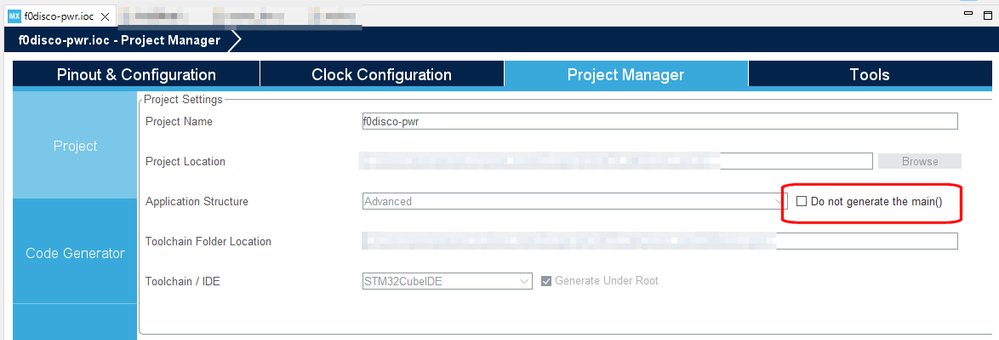

> But you can tell it to not generate the main.c file at all.
But I assume you lose the initialisations in main.c? Or where will they go?
2025-05-27 1:37 AM
Yes - you have to call them yourself.
2025-05-27 2:52 AM - edited 2025-05-27 2:53 AM
It is "Do not generate the main()".
"main.c" is always created apparently.
2025-05-27 2:58 AM
@TechyAry wrote:It is "Do not generate the main()".
So it is:
