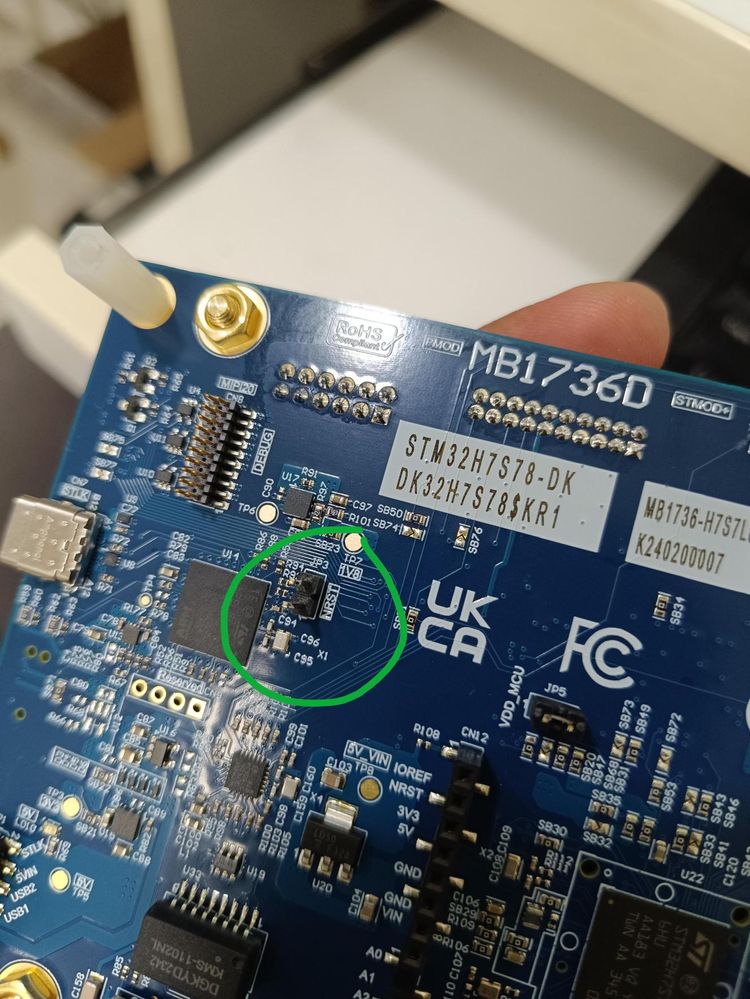

2024-06-23 10:21 PM
Hello @Imen.D, thank you for the connecting.
As you can see that the NRST Pin is open. I have also tried with "Hot plug" mode but the getting same error.
