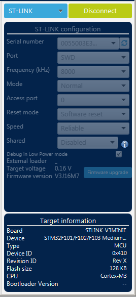

I just connected a miniE to a H7 board, to show:
connection at 24 Mb , cable to target about 12cm long.

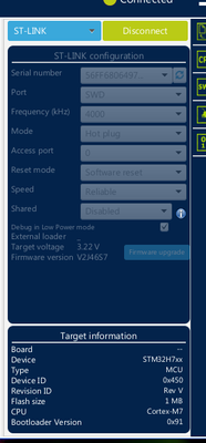

example:
- here st-linkV2 (stick...) to an H743:

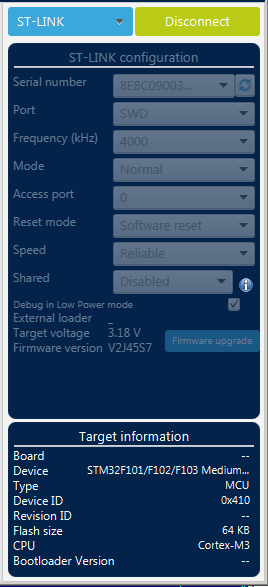

STLINK-V2 + bluepill:

I see here Revision ID is empty

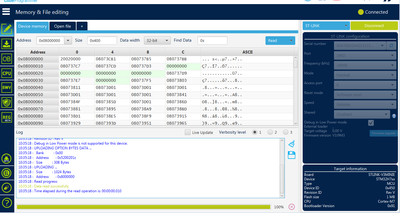

STLINK-V2 + new STM32 from different source:

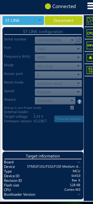

STLINK-V3MINIE + bluepill:
STLINK-V3MINIE + new STM32 from different source:
So we can conclude, obvious other manufacturer , but cortexM3 ("F103" name ).
(Or STM chip, but some first test series, that should not be come to the market...who knows.)
And your miniE is ok, also. Just you cannot debug in IDE with miniE, because there is a check for "genuine STM" cpu...
