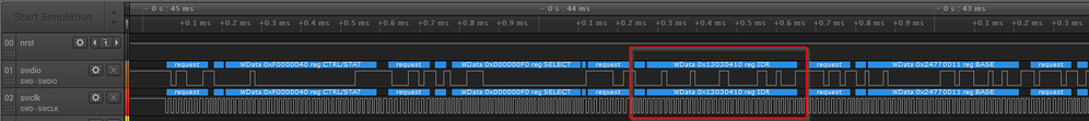

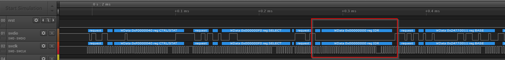

I looked into signals by oscilloscope. There was some activity, similar between STLINK2 clone and STLINK-V3MINIE.
Reset line had 1 pulse. SWCLK had proper clock signal,  SWDIO had some data.
Then I recorded communication with logic analyzer. Saleae Logic has luckily SWD protocol analyzer.
The communication is working at first glance.
First difference there is in length of reset pulse. In STLINK2 clone is very short, in STLINK-V3MINIE is much longer. STLINK2 first sends data, then sends short reset pulse. STLINK-V3MINIE holds reset line down and communicate with reset line down. I have no idea if it plays a role.
Then I compared data itself. I'm not familiar with SWD protocol.
I see first difference in WData at time -43.7ms (STLINK2) and +2.3ms (STLINK-V3MINIE) (time is relative to start of reset line trigger). Where is some "reg IDR" value.
In STLINK2: 0x13030410
In STLINK-V3MINIE: 0x00000000
