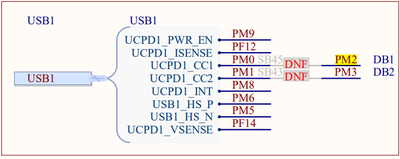

PM2/PM3 could be connected as dead battery pins to CC lines not to data lines !
