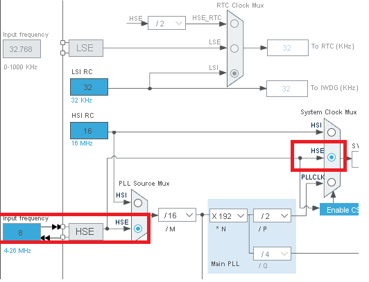

this looks like HSE is set to "bypass" .
shure, you have set it to "crystal.." and load /debug then ? and use MCO setting !
see circuit of dev-E board , F407 black board:
so add 500k ... 1 meg resistor in par. to crystal !

2023-05-21 3:11 AM
> Are there settings for the 8 MHz MCO signal that comes from ST Link?
no. except you set in clock settings an external 8M clock.
>Or is ST Link's 8 MHz MCO just a fallback for HSE?
no. is cheap standard clock on most nucleo boards, because stlink anyway there.
>There are no separate settings for MCO 8 MHz from ST Link?
no.
> STM32F407 microcontroller sees MCO 8 MHz from ST Link as HSE?
yes. is same as external clock oscillator for F407 ; can use the "bypass" clock setting.
(you have changed this, now F407 on his own crystal clock. )
