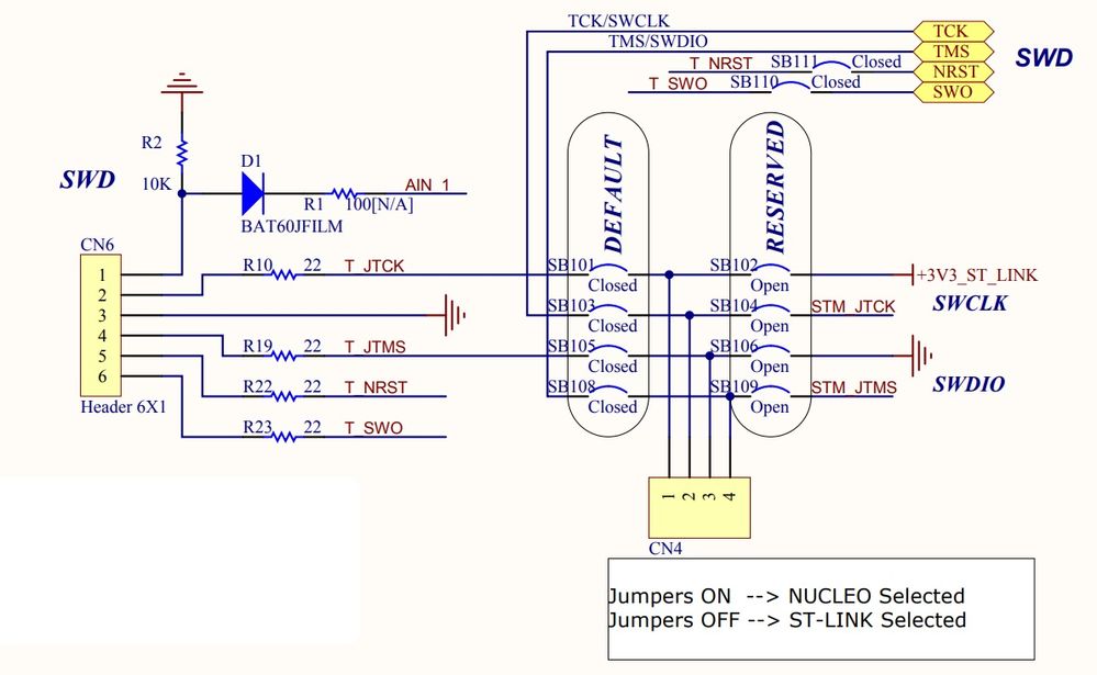

2024-05-08 1:07 PM
There should be a CN5 header diagram in the NUCLEO's User Manual
On the Lora E5 mini dev you should see DIO CLK GND 3V3
Disconnect the local target from the NUCLEO's debugger, remove jumper pair from CN4
CN6.1 3V3
CN6.2 JTCK/SWCLK
CN6.3 GND
CN6.4 JTMS/SWDIO
CN6.5 NRST
CN6.6 SWO/PB3
