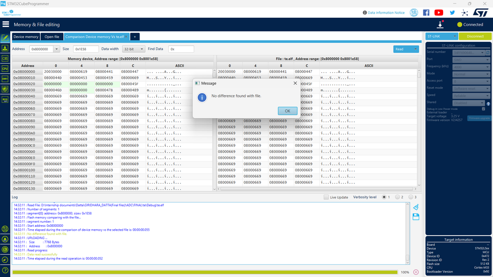

How are you sure the program is erased? did you check the flash content with STM32CubeProgrammer for example?

Show memory space with STM32 Cube Programmer.
Use tool to write.

No Sorry, I had not checked with the stm32cube programmer before.
Now I did, I compared the memory with the .elf file. It turns out the program is not getting erased but it is just not executing the program.

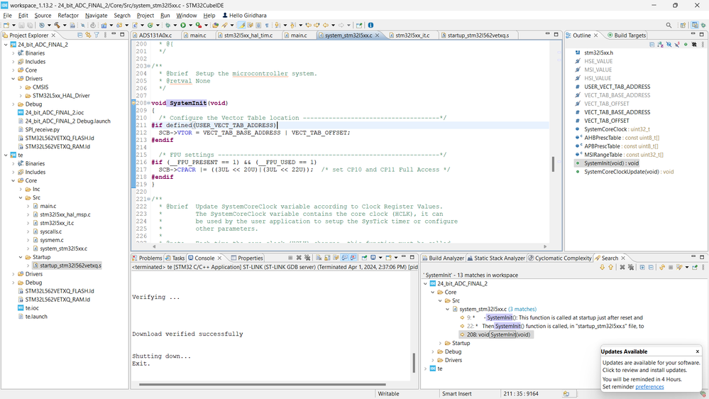

Here is the SCB->VTOR value:
Where
VECT_TAB_BASE_ADDRESS = (0x08000000UL)
and
VECT_TAB_OFFSET = 0x00000000U

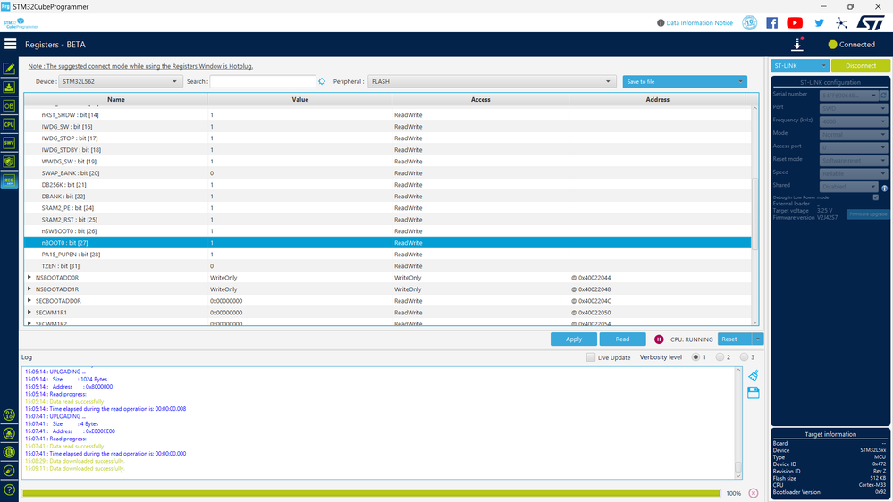

Check the boot configuration and boot pin
2024-04-01 2:45 AM
I tired to make it Zero and run again
but it's going back to HIGH state again
