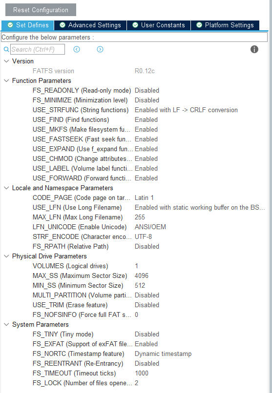

I am connecting it to the NUCLEO board through an Adafruit SD card module which has pullup resistors on all lines, including the detect pin, and I am using the internal GPIO pullup resistors too for D0, CMD and SD_DET to make sure the communication is uninterrupted. Below you can see the FATFS configuration

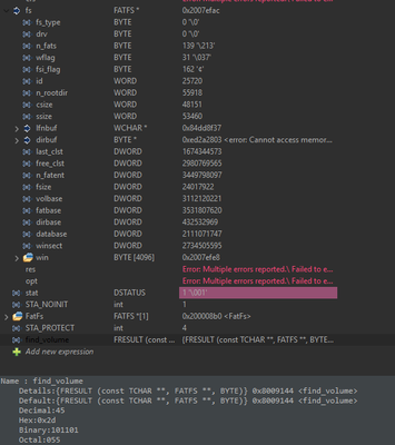

I stepped into find_volume() and it fails the check on line 14 of the last code excerpt I attached in my last reply.
This is what I get after the find_volume() function.

After diving a bit more into find_volume() from f_mount, assuming that vol = 0 is a valid value, I see that the condition in line 2 (code below) is not fulfilled, because fs_type returns 0 instead of FS_EXFAT, which should be the case according to the FATFS documentation which I attached here . It also seems like fulfilling that condition (fs_type!=0) is the desired case.
