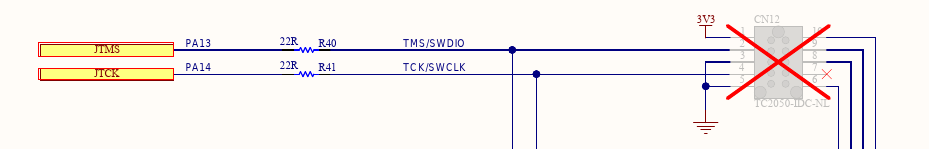

2023-05-13 11:39 AM - edited 2023-11-20 5:33 AM
come on - you need just swd connection; take some wires and connect it.
swd , swc, gnd . (+ software reset)
ok - this is a problem: is cn12 there ?
