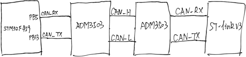

However, when I connected two CAN transceivers (ADM3503) between STM32F429 and STLINK-V3SET, in theory it should be able to connect successfully, but it actually failed to connect (prompt connection timeout).As shown in figure 2 is the connection diagram I drew,are there any errors? and why it can't work?

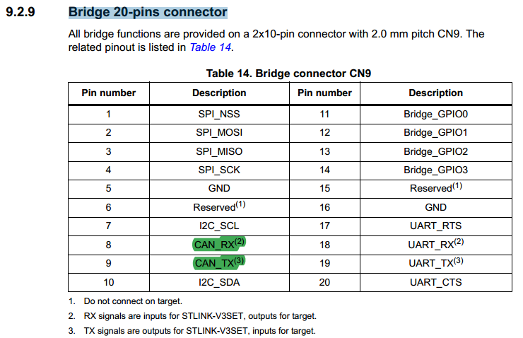

Then I found there have another interface to using CAN from UM2448(as shown in figure 3),but it still did not work,when I connected the outputs CAN_RX and CAN_TX of the ADM3503 to the CAN_TX and CAN_RX pins of CN9 on STlink-V3SET, respectively.
Another question is, I used a multimeter to measure that CAN_TX of CN5 and CN9 are connected, but CAN_RX is not connected. What is the reason?
figure 3

The CAN pins on CN5 do not require a CAN transceiver. If you look at the V3 manual you'll see that if CN5 is selected (with jumper JP7) then the signals on CN5 are T_CAN_TX (presumably this indicated transceiver CAN TX) and T_CAN_RX.
Using the CAN Tx and Rx on CN7 and CN9 both require the use of an external CAN receiver, whereas this is not the case on CN5.
