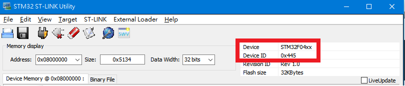

I've got some lovely tiny STM32F070F6P6 (with THIS package information on mcu) from china distributor.
Custom boards are made, chips are mounted.
When I start the ST-Link utility, it gives the following message:
Is this normal?
Or it's just a cloned F070, but with more functions like F04x?!
#stm32-f0 #st-link-utility #device-id2017-07-12 12:28 AM
I should remark that this presumed F070 is currently running a USB CDC function without any problem.

I've just received my new
STM32F070F6P6 from MOUSER ...Surprisingly the device ID is still 0x445 which means it's a F04x device.
I try to build some project for F040 and initialize some peripherals which don't exist in F030, (like I2S),
amazingly, it's working!!??

ST has been know to ship parts with more advanced die than the marking would suggest. If the F04x is a super-set of the F070 then that is a possibility.

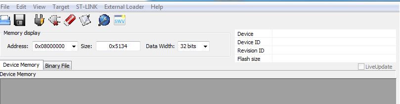

I have problem with STM32 loader as the picture : There is no device number and device ID !
