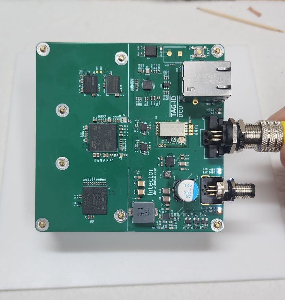

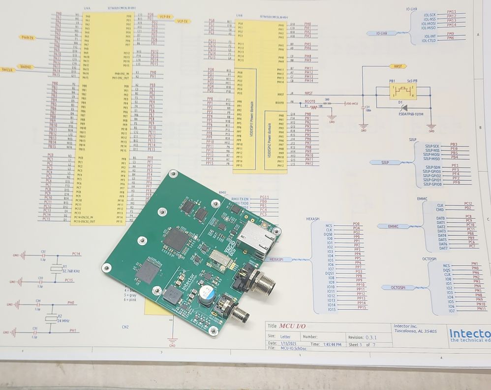

I'm working on a project for which I designed a custom board. It consists of the following components.
Arm® Cortex®-M7 32-bit 600 MHz MCU, 64 KB flash, 620 KB RAM, Ethernet, 2x USB, 2x FD-CAN, advanced graphics, 2x12-bit ADCs
1.8V 256M-BIT [x 1/x 8] Read-While-Write Octal SPI Memory
1.8V 256M-BIT Double-Data-Rate Octal SPI PSRAM with x8/x16 interface
8G-BYTE eMMC chip
MII/RMII 10/100 Ethernet Transceiver with HP Auto-MDIX and flexPWR® Technology
dual channel transceiver IC for SIO and IO-Link sensor applications
RC-SPIRIT2-915 module based on STMicroelectronics S2-LP transceiver
Here are some pictures of the board:

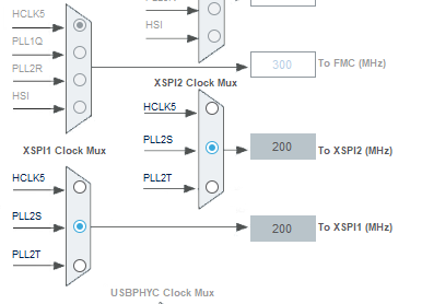

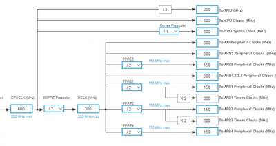

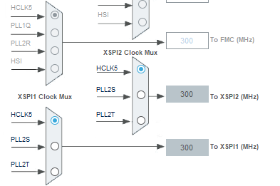

I'm using both XSPI, and this is how the STM32CubeMX generated code looks in my case:
EXTMEM_Init(EXTMEMORY_1, HAL_RCCEx_GetPeriphCLKFreq(RCC_PERIPHCLK_XSPI2));
EXTMEM_Init(EXTMEMORY_2, HAL_RCCEx_GetPeriphCLKFreq(RCC_PERIPHCLK_XSPI1));
There are two problems with this.
Point 1 is more of an inconvenience. If one tries to "single step" through this during debugging, it "single steps" into the routine HAL_RCCEx_GetPeriphCLKFreq but fails to step to the EXTMEM_Init function. The solution would be to have STM32CubeMX generated code look like this:
uint32_t tmpPERIPHCLK_XSPI1 = HAL_RCCEx_GetPeriphCLKFreq(RCC_PERIPHCLK_XSPI1);
uint32_t tmpPERIPHCLK_XSPI2 = HAL_RCCEx_GetPeriphCLKFreq(RCC_PERIPHCLK_XSPI2);
EXTMEM_Init(EXTMEMORY_1, tmpPERIPHCLK_XSPI2);
EXTMEM_Init(EXTMEMORY_2, tmpPERIPHCLK_XSPI1);
The second point in my former list is masking any problems during the EXTMEM_Init. This also explains the general understanding that one must write extra code to make the PSRAM work. The fact that STM published the famous application note AN5050 and uses it as the standard GOTO for any question related to XSPI shows the broad ignorance on that issue and provides an excellent example of the effects of error suppression.

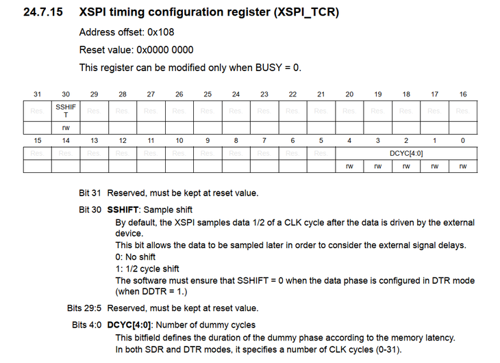

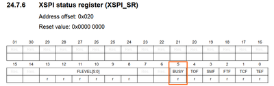

It uses the HAL functions to do the heavy lifting. If we follow the HAL_XSPI_Command function, we will find, besides a bunch of parameter asserts, a function call to wait for a flag to be set.
/* Wait till busy flag is reset */
status = XSPI_WaitFlagStateUntilTimeout(hxspi, HAL_XSPI_FLAG_BUSY, RESET, tickstart, Timeout);
In our case, we wait for the BUSY flag in the XSPI_SR register to be RESET with a timeout of 100ms.
Unfortunately, this will never happen, even if we wait forever.
We have reached the point I mentioned earlier where I ran out of coffee and energy to stay awake.

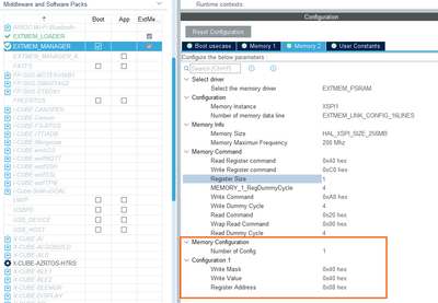

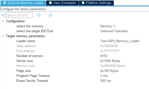

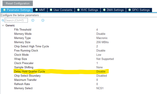

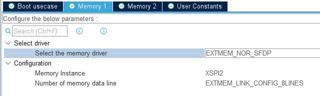

Many of the XSPI configuration parameters for the external Flash are irrelevant because the Memory Manager will use the Serial Flash Discovery Protocol to discover all crucial settings from the chip itself. The SFDP is only used if EXTMEM_NOR_SFDP is selected.
The EXTMEM_LOADER settings must be adjusted according to the used chip. These are the settings for the MX25UW25645GXDI00 chip that I've used:

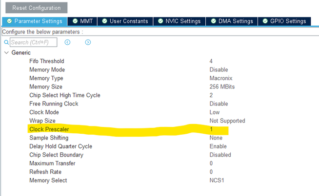

One of the most misleading XSPI parameters is the ClockPrescaler if one uses the Memory Manager. According to the choice of memory chips, the following functions are called from the middleware file stm32_extmem.c:
if (EXTMEM_DRIVER_NOR_SFDP_OK != EXTMEM_DRIVER_NOR_SFDP_Init(extmem_list_config[MemId].Handle,
extmem_list_config[MemId].ConfigType,
ClockInput,
&extmem_list_config[MemId].NorSfdpObject))
retr = EXTMEM_ERROR_DRIVER;
}if (EXTMEM_DRIVER_PSRAM_OK != EXTMEM_DRIVER_PSRAM_Init(extmem_list_config[MemId].Handle,
ClockInput,
&extmem_list_config[MemId].PsramObject))
These functions use SAL_XSPI_SetClock from the software adaptation layer. Here is a closer look at this implementation:

The memory's clock frequency is calculated using the function parameter SAL_XSPI_SetClock, and the ClockPrescaler parameter from the XSPI settings is not used. This is not an issue as long as it is mentioned anywhere in the documentation. The example code is using this:
This approach is not a good solution in several ways. The function HAL_RCCEx_GetPeriphCLKFreq returns the XSPI's "Input Frequency," which happens to be 200 MHz in my case. If one runs the MCU on 600 MHz and selects the HCLK5(the default setting), the XSPI "Input Frequency" will be 300 MHz. The memory chips will not work at this speed, and the hunt is on.
The other problem with the EXTMEM_Init implementation is that the function's return value is ignored, any error during the initialization is masked out, and the "wild goose chase" is on its way.
The Memory Manager parameter MemorySize requires the unit MBit instead of MByte. This is wrong in the firmware examples and could confuse.

This leads the user to believe that the prescaler value in the STM32CubeMX settings is used, which is not correct.
The entered value for the Clock Prescaler is not used by the "Middleware." This means the memory always runs at the maximum frequency set by the XSPI initialization.
If one leaves the settings at HCLK5(default) and the MBU settings are maximum, the memory must run with 300 MHz.
This is because the default maximum setting for HCLK5 is 300 MHz.
In other words, memory will not function, and we will have a goose hunt, which could keep us busy for days.

}We will know something went wrong, but what the problem was is everyone's best guess. This modification would be inside the "Middleware" files, which I haven't done.
The other thing is that the XSPI parameter for the DHQC is available despite the fact we selected an STM32H7RS device.
It was unclear that the DHQC doesn't exist on these devices, so I set this to Enabled, following the recommendation in the famous AN5050 document. The RM0477 does not have the DHQC flag listed, which made me curious, and @KDJEM.1 explained that this flag does not exist on the STM32H7RS devices. This would explain why the RM0477 recommends leaving all other bits at the TCR register at 0.
I'm unsure what happens if one sets bit 29 to 1 in an STM32H7RS device. Maybe nothing happens at all, or maybe a wormhole opens somewhere in the Andromeda galaxy.
Those are the significant things that I found that made getting my system running difficult. I published a repo with the working "Test-XSPI" project on GitHub just in case somebody else plans to use the XSPI on any STM32H7RS device. Maybe that will help those people save some time and a headache.
