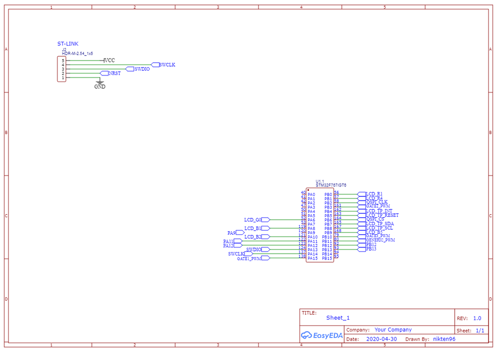

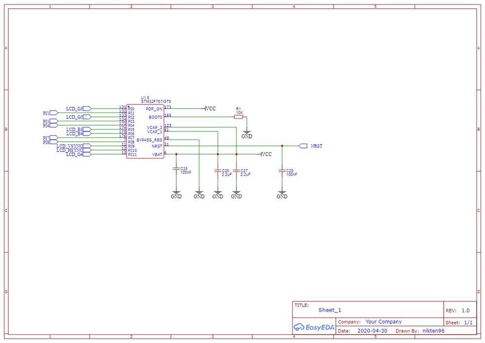

i created a custom board which foundamental schematic is like the images:
I'm using the classic ST-LINK USB Debugger but i can't debut nor upload my code inside my STM32F767IGT MCU, both with STM32CubeIDE and STM32 ST-Link UTILITY.

2020-05-28 12:31 PM
Typically each should be individually wired to own capacitor. Expect 1.2V on these pins
Definitely not connected to VCC
2020-05-28 12:26 PM
VCAP_1 and VCAP_2 should not be connected to VCC. Even if you fix this, the chip may be dead since the voltage on those pins is normally around 1.2V.
2020-05-28 12:31 PM
2020-05-28 6:21 PM
Perfect, it works now! Thank you!
