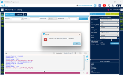

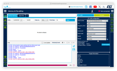

My company recently purchased a new ST-Link/v2 programmer. The problem is that after the firmware update, the device stopped working, and when I press the Connect button on the STM32CubeProgrammer, the following error appears:
Error: ST-LINK error (DEV_USB_COMM_ERR)
I tried using an ST-Link/V2 programmer I bought a few months ago, and everything works fine (I only replaced the programmer, same USB cable, same programming cable).
The programmer is original, I'm sure of it. I purchased the programmer from DigiKey.
Even the serial number I see appears to be genuine.
When I try to update the firmware, I get the following result:
Can anyone help me solve my problem?

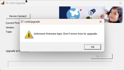

2025-09-16 1:52 AM
Hi Pavel, thanks for the reply.
Unfortunately, my company forced me to choose MAC :(
I followed your advice using a Windows PC and these are the results:
Nothing changed. Do you have any other suggestions? The device is brand new. All I did was update the firmware.
Thank you.

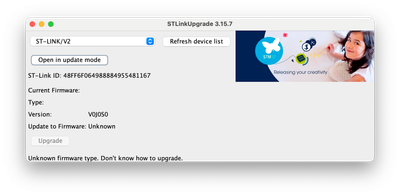

2025-09-16 1:59 AM
Hi Imen, thanks for the reply.
I already clicked the "Open in upgrade mode" button.
The first time I click it, the following message appears:
"Error connecting to device ST-LINK/V2 (error 0x1); check the USB connection and refresh the device list"
The second time I click it, the following message appears:
"Unknown firmware type. Don't know how to upgrade."
Look at the images I attached.
I also used a Windows PC and installed the latest version of STM32CubeProgrammer, but the results were the same (see my reply to Pavel).
Thanks.
Stefano

2025-09-18 4:45 PM - edited 2025-09-18 4:47 PM
The root of the problem seems to be that the updater does not recognize the present firmware version V15J63S63
Which looks totally weird. The number after V can be 2,3,4. Not 15.
Has someone else played with it? Updated it with J-Link or other 3rd party firmware?

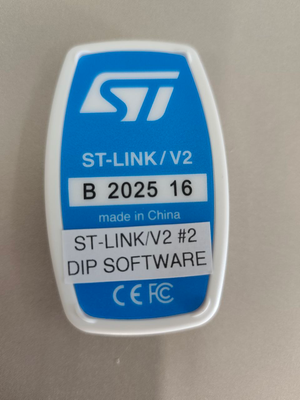

2025-09-23 1:11 AM
Hello Stefano,
Unfortunately this is not a recoverable error, you should return the ST-Link and exchange it with the distributor.
To understand better the issue you faced, you may answer the following questions:
To check if it is a genuine ST-LINK/V2 could you provide a picture of the box and its stickers and of the provided accessories?
