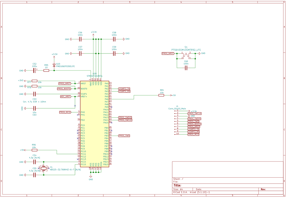

I've designed a custom PCB incorporating STM32F401RE. I've received the first batch of PCB and attempted to program one, but STM32CubeIDE raises the error line as in the title ("No device found on target").
I've kept the design (see image) as close as possible to the Nucleo64-F401RE, and also cross-checked AN4488 ("Getting started with STM32F4xxxx MCU hardware development").
I couldn't find any red flags so far, but maybe some of the fellow forum members could give me a critique of the design. Am I missing crucial details?
Please note that I've deleted a good number components that are not required for programming; These are not yet soldered onto the PCB so the schematic reflects the circuit as-is.
I further run tested a number of basic tests which mostly came out ok:
I hand-soldered the board and it is thus possible that I've damaged the IC doing so. However I am experienced in the matter and considering the current supply situation I made very sure that I am handling the device well.
I have a second, spare IC to check against - but right now I'd like to avoid that, because it will be nearly impossible to get a replacement at the moment.
Thanks for your attention and I would be very glad about some pointers.
Best regards

2021-10-19 6:45 AM

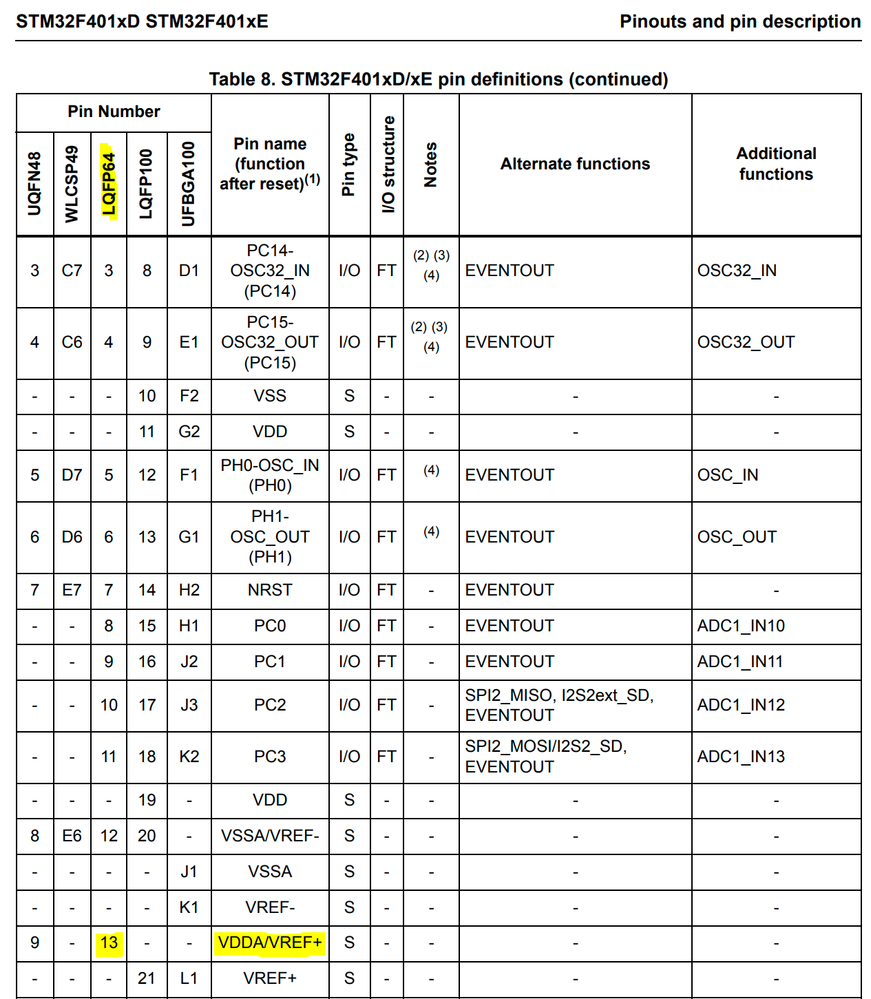

Pin 13 is VDDA/VREF+ (not just VREF+). You'll need to connect this to VDD. This means you won't be able to have a voltage reference source separate from VDD.

2021-10-19 6:48 AM
Right! Of course, that was also mentioned in the thread I linked. My KiCAD symbol hat the pin labeled as VRef+ and I was lazy checking. That seemed to do the trick.
