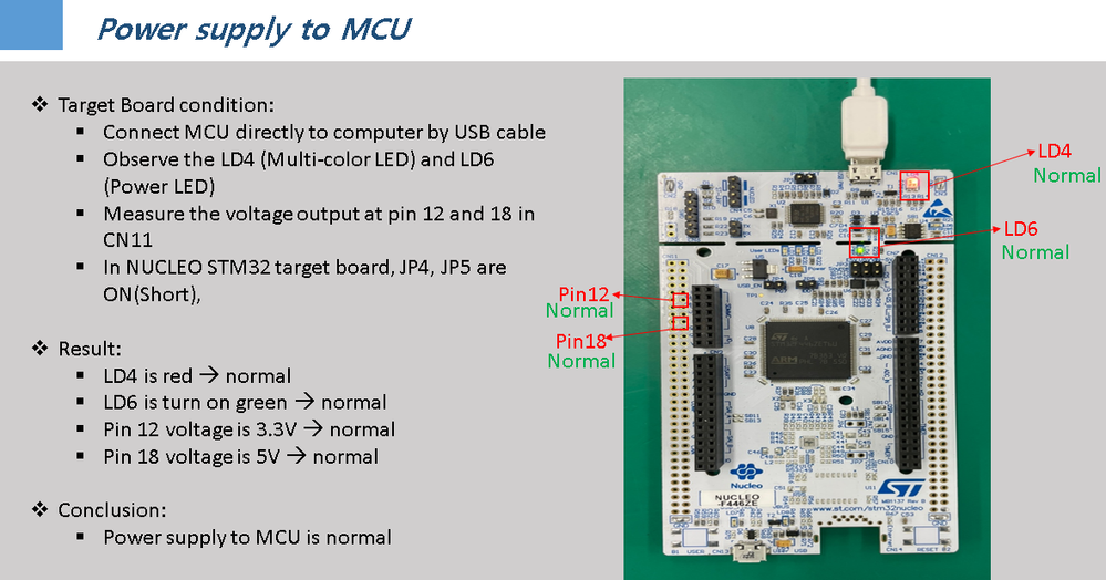

And also checked the VDD power on the board, and all of the digital power is in normal operation.

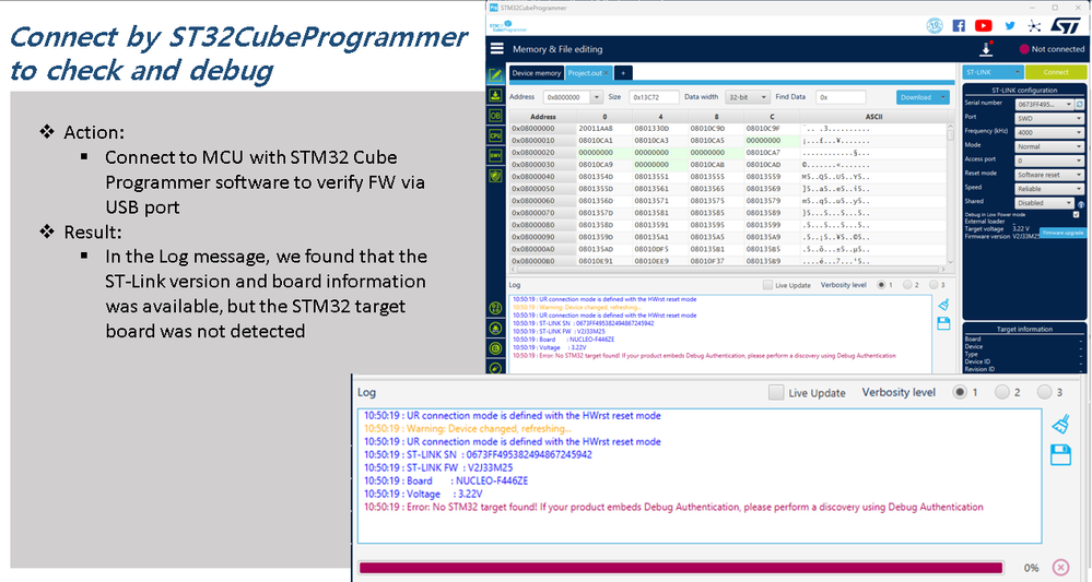

@KDJEM.1 And we tried to connect to MCU with STM32 Cube Programmer to verify FW via USB port. In the Log message, we found that the ST-Link version and board information was available, but the STM32 target board was not detected. In the results, the disconnection to the target board issue was the same.

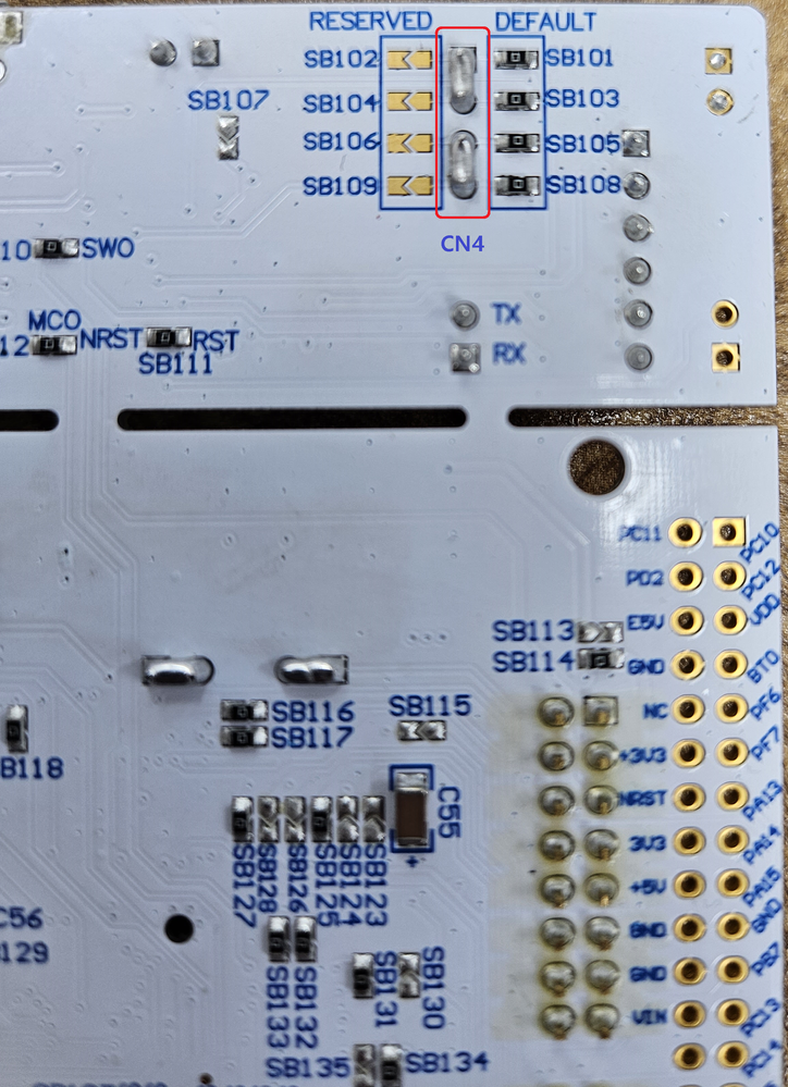

2023-04-17 7:52 PM
Put the jumpers back on CN4
2023-04-18 6:04 PM - edited 2023-11-20 8:13 AM
We have shorted the CN 4 from the backside of the board.
I think that It is the same as putting on the jumpers of the CN4.
