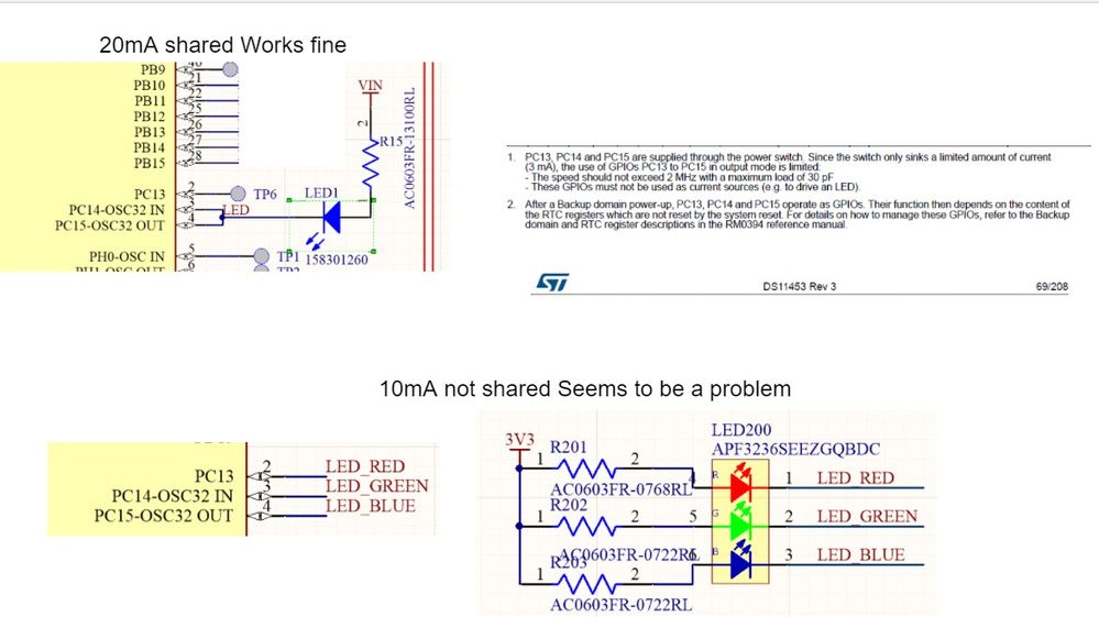

I'm running two different boards with the same chip (STM32L431) and firmware.
I have some debug LEDS on my board that flash 1sec on, 1sec off in open-drain configuration.
In one case its an RGB led where I flash blue and green (10mA each)
In the other case its a while LED that shares the same 2 pins (20mA total)
Over time, it seems that this eventually burns out the MCU (first getting hot, then breaking all together).

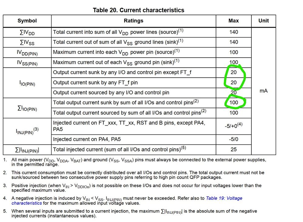

According to DS11453 Table 20. Current characteristics, you can easily run LEDS like this.
However!. I chose were PC13, PC14 and PC15.
While is says Nothing at all about this in Electrical Characteristics. It does say at the very end of table 15 "pin definitions"... "except exactly these pins" and says they specifically are limited to 3mA.
Personally I think this is a little easy to miss... but, my bad. Hardware is hard.
The only catch here is that.
Burnout of the chip, only occurred in the RGB case (10mA per pin) . And it took hours for it to actually get hot (again, the 2 colors were used, so only PC14 and 15)
In the white LED case: this actually ran just fine for weeks without getting hot.
(It's a prototype, I did not test longer).
According to AN4899 chapter 5.3.1 "White LED drive" One can distribute greater loads over multiple GPIO connections as long as one does not exceed the current capacity of the chip or the port.
As you can see , my design is not correct because you are supposed to use 2 resistors and distribute the current evenly across the pins.

These pins, going all the way back to the original STM32F1 design are in the LOW POWER domain, with the RTC, and potentially powered by a battery. They have smaller transistors, and purposefully designed IO cells to reduce the power consumption in SLEEP and STANDBY states. The switch is designed to draw from the primary system power whenever that's available. In some of the L series parts it is a common supply, as the whole chip is expected to be battery powered, but it still wants to have a minimal portion of the chip to be powered to reduce consumption to an absolute minimum.
In most STM32 the LSI will not run the RTC in low power modes, but need an external watch crystal via PC14/PC15
